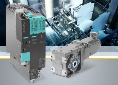

Siemens has expanded its extensive drive portfolio for servo applications to include the Simotics S-1FG1 servo geared motors, which are designed for use with the Sinamics S120 drive system.  Sinamics S120 drives and Simotics S-1FG1 servo geared motors are an integral component of Siemens Totally Integrated Automation (TIA), which reduces engineering time and costs.  Pre-fabricated Motion-Connect signal and power cables offer an easy and reliable method of connecting the components.  The units have electronic rating plates and the motors are connected via the Drive-Cliq system interface, so the system can be brought online quickly.
The engineering of the Simotics S-1FG1 servo geared motor includes high efficiency and low torsional backlash for precise, dynamic motion sequences and is available in the following versions: helical, parallel shaft, bevel and helical worm gearboxes with up to 25 transmission ratios, depending upon the type of gear and gear size required.  The helical gearing of the gearboxes reduces noise and offers high efficiency.
With its highly integrated functionality and scalable number of axes, the S120 drives are suitable for use in a number of demanding motion control applications such as printing and packaging machines, storage and retrieval machines, material handling conveyor systems and dosing pumps.  The high-performance single and coordinated multi-axis drives with servo control enables ideal solutions for an increase in overall line productivity and flexibility.
