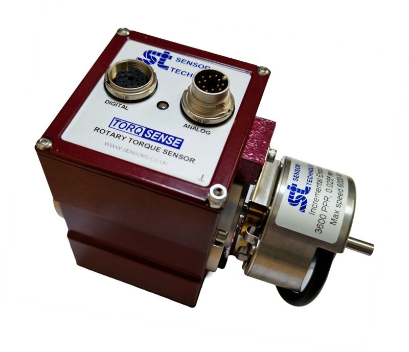

Sensor Technology Ltd. introduces the SGR523, a rotary torque sensor equipped with an integrated incremental angle encoder. This addition to the TorqSense SGR series provides torque and angular position monitoring across various industrial applications.
The SGR523 employs non-contact strain gauge technology, eliminating the need for traditional slip rings and enhancing reliability. Its high-resolution angle encoder delivers up to 10,000 pulses per revolution with a resolution of 0.009°, making it ideal for applications requiring meticulous torque-angle analysis, such as mechanical testing, automated assembly, and process control.
The SGR523's advanced capabilities enable engineers to detect mechanical anomalies, such as rotational stiction or thread damage, by analyzing torque versus angle plots. This dual-parameter monitoring is crucial for quality assurance in manufacturing processes, including bottle cap tightening and bolt fastening. Additionally, the sensor's ability to monitor torque at specific shaft angles aids in identifying potential issues in process control applications, thereby reducing production wastage. Its high-resolution angle measurement also facilitates precise motion control, allowing for better management of inertia in motion platforms and improved safety in automated machinery.
The SGR523's design simplifies system architecture by combining torque and angle measurement into a single unit, reducing component count and enhancing system reliability. Its robust construction and advanced diagnostics, including Built-In Test (BIT) self-diagnostics and shaft temperature monitoring, ensure consistent performance even in demanding environments.
