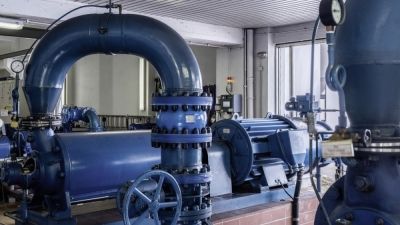

At the Hannover Messe 2018, Schaeffler will be presenting intelligent solution packages for machine monitoring and lubrication, illustrated using reference projects. One such customer is the Perlenbach water supply association, which supplies fresh drinking water to roughly 50,000 residents in seven municipalities of Germany’s Eifel region every day. Ensuring fault-free and reliable operation would mean manning and monitoring the association’s facilities 24 hours a day, since bearing defects in the centrifugal pumps could cause them to fail and compromise the security of the water supply. Perlenbach therefore decided to utilize a system that would continuously monitor and lubricate the machinery. In Schaeffler, the water supply association found an expert partner to help implement a predictive maintenance system.

Together with the Concept8 lubricator, the preconfigured SmartQB condition monitoring system ensures fault-free operation. The stand-alone complete solution detects irregularities in electric motors, pumps, fans, and the rolling bearings that all of them contain. The SmartQB identifies the potential cause of failure – whether it’s bearing damage, imbalance, friction, a temperature increase, or changes to the vibration pattern – and gives a clear text notification of the findings. The integration of the system, which was developed in partnership with Mitsubishi Electric, into the control room visualization means that maintenance personnel are informed of incipient damage at an early stage and can immediately initiate maintenance measures and procure any replacement parts that might be needed. As Joachim Dankwardt, deputy manager of the water procurement/treatment department at the Perlenbach water supply association, is well aware: “For us, condition monitoring means a secure supply.”
No previous knowledge required
A major advantage of the solution is that the SmartQB is a preconfigured plug-and-play system, which makes it very easy to put into operation. “Conventional systems for machine monitoring are costly and complicated. In contrast, the SmartQB is so easy to use that our employees did not require any specific knowledge of vibration diagnosis. We were able to start right away,” reports Dankwardt. The electrical specialists on site were able to connect the SmartQB directly to the control system and the emergency telephone equipment.
Requirement-based relubrication
The last pump failure to occur at Perlenbach was caused by the overlubrication of a bearing. Schaeffler counteracts this problem with its Concept8 lubricator, which precisely supplies up to eight lubrication points with the correct quantity of grease. Insufficient lubrication or overgreasing and the resulting damage can thus be prevented. The power supply to the lubricator is coupled to the pump, which means that lubrication only takes place when the relevant pump is actually running.
