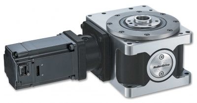

Sankyo Automation Rotary Indexing Table Provides Zero Backlash
The Sankyo Automation RollerDrive Reducer is a precision gear reducer that uses a zero backlash roller gear mechanism. The unit is constructed from an input shaft and a turret (output shaft) that is assembled with roller followers. The roller followers are preloaded against a screw-like input shaft to eliminate backlash.
Sankyo servo indexing tables offer a constant lead cam with a servo motor drive for programmable motion. Sankyo servo indexing tables provide fast highly accurate motion, with the added capability to move medium to heavy loads. The preloaded cam & turret provides a high performance zero-backlash servo indexing table for all your automation needs.
The RU Series servo indexing table is available in 11 different sizes. These servo indexing tables come with varying ratios to maximize the motor’s torque capacity, speed requirements and enhance the overall accuracy. Special applications may require double reduction ratio of the internal cam and an additional reducer to provide large torque capacities or slower speed.
