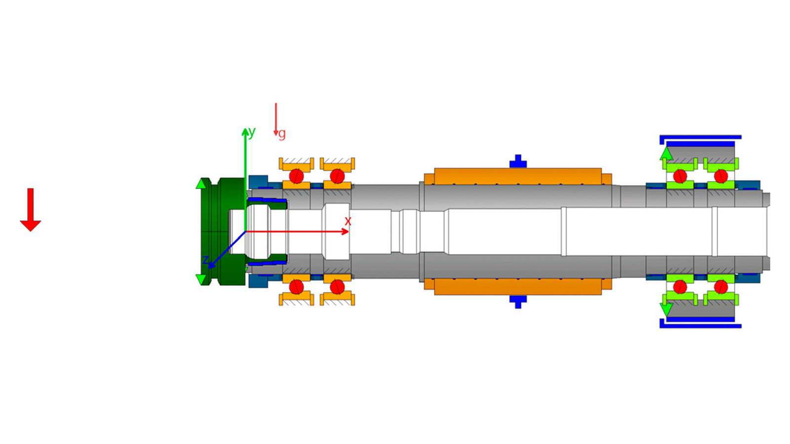

The investigated hypothetical application is a high-speed motor spindle for aluminum machining, with a maximum torque of 10.75 Nm and a maximum rotational speed of 36,000 rpm. An HSK-F63 interface is used as the tool holder. The applied tool radius is r = 12 mm, corresponding to an end mill with a diameter of 24 mm.
Bearing Concept:
The spindle is supported by two spring-preloaded O-arranged tandem bearing sets, each consisting of a front and a rear bearing pair. The following bearing configurations are used:
  • Front bearing pair: 7010, contact angle = 18°
  • Rear bearing pair: 7010, contact angle = 18°, spring-preloaded with 1,300 N
This arrangement corresponds to a typical configuration for high-speed motor spindles. It allows for the accommodation of thermal expansion in the axial direction while maintaining high stiffness and performance capacity.
Mounting Orientation:
The spindle is horizontally mounted, which prevents the front bearing set from being unloaded by gravity. This positional effect is considered in the calculation.

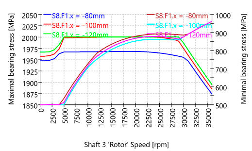

The following limit states are considered in the simulation:
  • Minimum Hertzian pressure:
    pmin > 500 MPa
  • Maximum Hertzian pressure:
    pmax < 2,000 MPa
  • Spin-to-roll-ratio
    < 0.3
  • Maximum transferable torque:
    Mx < 10.75 Nm

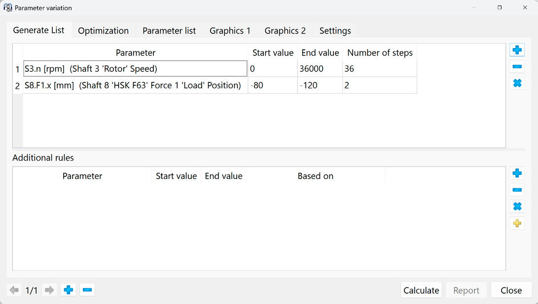

Parameterization and Evaluation
The MESYS shaft calculation module is used to determine the load limit curve. The optimization function for parameter variation “maximize input based on conditions” is applied to determine the maximum permissible loads while complying with defined limit values.
The software iteratively increases the load if all limit conditions can still be met simultaneously. In this way, a maximum permissible force combination is determined for each speed level.
  • pmin limits x = –100 mm up to 4,000 rpm
  • pmax limits x = –100 mm between 13,000 and 24,000 rpm
  • pmax does not limit x = –80 mm
  • Mx limits x = –100 mm from 5,000 to 12,000 rpm and from 25,000 to 28,000 rpm
  • Spin-to-roll ratio limits x = –100 mm at B1 from 29,000 to 36,000 rpm
  • The motor power cannot be fully exploited at x = –120 mm, as pmax is the limiting factor

Results and Interpretation of the Load Limit Curve
The resulting load limit diagram shows the maximum permissible load on the motor spindle as a function of rotational speed, while complying with all previously defined limit conditions.
Key findings from the curve envelopes:
At low rotational speeds (< 5,000 rpm), the load is limited by falling below the minimum bearing pressure. This is intended to prevent bearing tilting and potential loss of contact.
In the range between approximately 5,000 and 30,000 rpm, a wide usable band emerges in which the spindle’s load capacity can be largely exploited without reaching critical bearing conditions. This range is therefore considered an economically efficient operating window.
From around 30,000 rpm onward, the spin-to-roll criterion at rolling bearing 1 becomes the limiting factor, as radial loads at very high speeds can disturb the bearing kinematics and lead to associated issues.
Overall, the generated load limit curves clearly illustrate both the design reserves and the physical limitations of the spindle. They provide a basis for defining suitable application ranges, planning machining strategies, and avoiding critical overloads.
