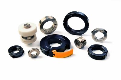

To match the varied needs of machine tool manufacturers, Ruland Manufacturing Co., Inc. offers over 2,500 standard shaft collars. Machine tool manufacturers require round bore, threaded, and bearing locknut type shaft collars to meet the diverse needs of mills, lathes, bar feeders, coilers and other CNC controlled equipment. Ruland clamp style shaft collars are manufactured from select materials, have fine finishes, high holding power and precise face to bore perpendicularity, making them ideal for the demands of machine tools.
Clamp style shaft collars can be used for guiding, spacing, stopping, mounting and component alignment. They are superior to set screw shaft collars as they do not mar the shaft, are easy to install and adjust, and have significantly higher holding power. Ruland two-piece clamp style collars can be serviced in-place, offer increased holding power, and are mated throughout the manufacturing process for proper fit and alignment. Machine tool manufacturers benefit from the tightly controlled face to bore perpendicularity of Ruland shaft collars (TIR ≤ 0.002 inch or 0.05 mm), which is critical when they are used as a load bearing face or for aligning components such as bearings or gears. Ruland identifies this work surface with one or two circular grooves on the face of the shaft collar to assist in installation and design.
Threaded shaft collars and clamp type bearing locknuts are common on lathes, mills and other equipment that require higher axial holding power. Ruland manufactures them with double tapped burr-free threads, allowing for smooth installation and removal, proper fit and extended shaft life. Bearing locknuts are designed to fit AFBMA standard shafting and utilize a clamp style design for high holding power. They have more precise face to bore perpendicularity of (TIR ≤ 0.0005 inch) to accommodate the needs of high precision spindle bearings.
Ruland shaft collars are made from bar stock sourced from select North American mills and carefully manufactured in Ruland’s factory in Marlborough, Massachusetts, using proprietary processes and under strict controls. Fastening hardware tests beyond industry standards for maximum torque capabilities and holding power. The Ruland name and bore size are stamped on every shaft collar for ease of identification.
