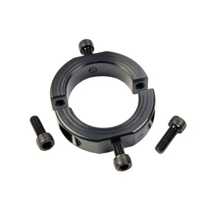

Ruland has released a new line of mountable shaft collars with flats and tapped holes or tapped holes only in the outer diameter, allowing for easy mounting of shaft collars to each other or adjacent assemblies. Clamp style designs are used allowing for benefits such as not marring the shaft, indefinite adjustability, and high holding power.
Ruland mountable shaft collars can be used in a wide variety of applications. In application with perpendicular shafts designers can mount or stack the shaft collars to each other. The additional hardware can be removed, allowing the collars to be welded together or to adjacent components such as hinges. Mountable shaft collars are available with holes only in the outside diameter for mounting sensor brackets or similar components.
Mountable shaft collars can be used for guiding, spacing, stopping, mounting, and component alignment. They possess equivalent holding power to standard shaft collars. Designers benefit from the tightly controlled face to bore perpendicularity of Ruland shaft collars (TIR ≤ 0.002 inch or 0.05 mm) which is critical when they are used as a load bearing face or for component alignment. Ruland identifies this work surface with one or two circular grooves on the face of the shaft collar to assist in installation.
Clamp shaft collars distribute compressive forces evenly around the shaft for a tight fit and significantly increased holding power when compared to set screw collars. This design is especially useful for designs with high impact loads or components that are frequently repositioned. Two-piece shaft collars offer increased holding power, in-place servicing, and are mated throughout the manufacturing process for proper fit and alignment. The Ruland name and bore size are stamped on every shaft collar for ease of identification.
