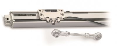

RSF Elektronik now offers a linear motion feedback encoder system that is designed for machines with loose mechanical motion during operation. Called the MSA 37x series, these encoders are designed for motion applications such as press brake and metal forming/bending machines, or any other type of machine that have significant flexure near the area requiring motion feedback.
Available in North America through Heidenhain Corporation, the MSA 37x series has a design that includes a bearing set internally for guiding the scanning optics, and a bearing set externally for the attachment of a coupling rod that affixes to the machine, thereby allowing for measurement of the moving elements of the machine.
