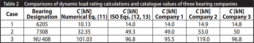

As discussed (Ref. 7) using the above equations and a simple Vernier caliper, it is possible to quickly verify the dynamic load rating of any bearing that can be disassembled and measured. Notice that Equations (12) and (13) require all distance in [mm] with the resulting load C in N.

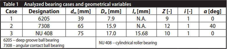

Calculation examples of dynamic load rating. In order to show the results from Equation (11) and to compare it with the ISO methodology, a few simple bearing cases are selected for calculation purposes. A summary of the cases and main geometrical parameters are summarized in Table 1.
The cases of Table 1 have been calculated using Equation (11) and also Equations (12) and (13). The results are compared with the catalogue values of three well-stablished bearing companies; Table 2 shows this comparison. The reader should also be aware that the values quoted by the bearing manufacturers normally are rounded off using Renard series, which may introduce variability of up to ±4% from the exact calculated value.
Table 2 shows that, in general, calculated values with the equations from the ISO standard, Equations (12–13) are slightly higher values than Equation (11) — except for case 3, where the opposite occurs. This generally matches well the increase in the factor by ISO over the years. For instance, at the present time the standard (Ref. 1) gives bm = 1.3 for cases 1 and 2 and bm = 1.1 for case 3. Multiplying the values given in Equation (11) by these factors produces very similar values as the ones given by Equations (12–13). For the case of the roller bearing (case 3), there is a clear deviation (higher value) when the result of Equation (11) is compared with the results of Equations (12–13), the source of this difference is unknown, but it is suspected that it might come from the simplifications introduced by the approximated equations. However, the general methodology for the calculation of C remains valid in the present time when corrected with the bm factor. When it comes to the values given by the different companies, bearings of similar performance class and similar dimensions and static load rating were chosen when possible. It can be seen that there are some significant differences among them, and also, in some cases, with respect to the ISO values. Inspecting the values of the dynamic load ratings of Table 2, Company 2 seems to have applied larger technology factor bm than the ISO standard for all three cases that are examined.
For practicing engineers, the comparison shown in Table 2 is both self-explanatory and revealing. As discussed (Ref. 2), some bearing companies seem to deviate from ISO when it comes to such performance parameters as the dynamic load rating. In those cases, engineers are entitled to ask for explanations regarding the motivations that led to those deviations; as, for instance, different design, tolerances, material, and heat treatment and related confirmation of tests validating the change in load ratings. Even more important for engineers is to question the dynamic load ratings applied by recently established bearing companies which do not have endurance testing capabilities or facilities, yet quote in their catalogues the same (or higher) performance rating values as the ISO 281 standard.

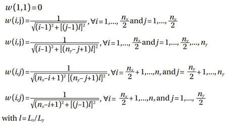

General elastic contact solver. There are many numerical schemes to solve the general (3-D) elastic dry contact problem, but here the FFT methodology described in (Ref. 11) is used. Since this methodology is described in detail elsewhere, only a summary is included hereafter.
Following the description (Ref. 11) for a given pressure distribution on a half-space p(x,y), the surface elastic displacements u (x,y) can be calculated using Fast Fourier Transform (FFT) by applying the following equation.
(14)
where w is a matrix containing numerical factors and is known as the frequency response function. For the elastic homogeneous problem, this matrix is calculated as follows:
(15)

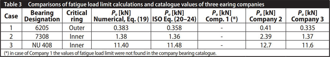

Calculation examples of fatigue load limit. The same bearing examples given in Table 1 are used for the fatigue load limit calculation. Also, the catalogue values published by the same three different bearing manufacturers will be investigated. The methodology described in the previous sections is applied and the results are summarized in Table 3.
In the calculation for cases 1 and 2, the radii of the inner ring grooves are also required. This information is not available for the three selected bearing manufacturers, but based on ISO geometry values (Ref. 1), approximations can be used. Thus, for cases 1 and 2, ri ≈ 0.52Dw and re ≈ 0.53Dw.
For case 3, a straight roller profile with rounded chamfers is used in the calculation. For illustration purposes, the calculated results of case 3 (NU 408) are depicted (Fig. 1), where the contact pressure and sub-surface orthogonal shear stress τXZ are shown.

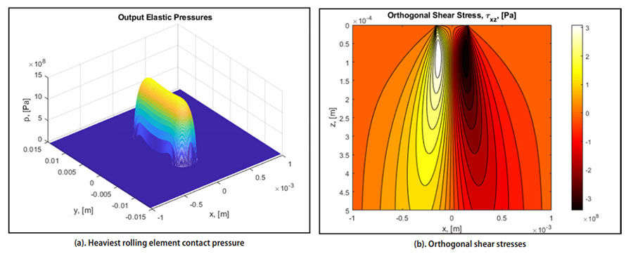

Figure 1: Contact pressure and orthogonal shear stress τxz for the heaviest loaded contact in the inner ring for the case 3 of Table 3.
Notice that, for all the cases of Table 3, a somehow smaller limiting stress than the one given in ISO has been applied. The reason is that this stress has variability — as explained (Ref. 9). Initially, it is based on a value, max(τxz) = 360 ± 4% MPa, that corresponds to a maximum contact pressure of 1500 ± 4% MPa thus in order to be conservative in the calculation a minimum value of max(τxz) = 346 MPa was selected, which corresponds to a maximum contact pressure of 1,442 MPa. The maximum stress in Fig. 1(b) is max(τxz) = 349 ± 4% MPa, very close to 346 MPa.
Another observation from the results of Table 3 is that only open information for 2 of the 3 companies was found for Pu. It can be seen that Company 3 agrees somewhat well with the numerical and ISO methodologies, while Company 2 has substantially higher values. It is true that some companies have “higher-performance” bearings (reduced manufacturing tolerances, higher geometrical precision, improved surface finish, etc.) resulting in longer fatigue life which, in a way, could be considered as an increase of the value. But this would be non-conformal with ISO, since the value of the fatigue limit in ISO has been fixed and it is standardized to a mean of value of τxz  = 1500 MPa with ± 4%.
Therefore the only feasible way to affect the fatigue performance of the bearing in a way that is consistent with the ISO requirements would be to use Equation (2) and modify the penalty factor ηa by redefining the value of the macro-scale stress factor . In this way it is clear that the fatigue limit of the bearing material is not affected by technological manufacturing improvements, and the progress in the bearing quality is indeed represented by rating factors that are designed expressly for that end. Load rating practices that simply increase the value of the fatigue load limit of the bearing Pu to reflect technological improvements are non-conformal with ISO 281. This may generate misperception in bearing users and distrust in the applied rating system as a whole. Thus these practices should be avoided.

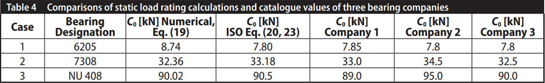

Calculation examples of static load rating. The same examples are considered. Table 4 shows the results and comparison with values given by the three main bearing manufacturers. It can be seen that in general there is good agreement between the calculated values and reported values from different manufacturers. The numerical method shows also minor deviations. Taking the ISO values as reference, the maximum deviation is of 5% observed for Company 2; but this is to be expected since the exact details of the bearing internal geometry are unknown and approximated here. This can introduce the observed variation.
For practicing engineers, the comparison of C0 values can be a good reference point when bearings of very similar internal geometry and material hardness are compared. It can be seen that there is more consistency among different bearing manufacturers with this load performance parameter than with any of the others.
