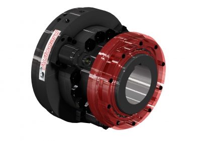

Rexnord’s Autogard 820 Series Torque Limiter is now available with the option to Remote-Reset, an option that is suited to applications where the control center and the equipment are a considerable distance apart, or where the Autogard Torque Limiter is positioned behind complex guards and covers. From its disengaged position, the Autogard 820 Series Remote-Reset (RR) Torque Limiter can be reset in seconds using pneumatic controls without the need to physically approach the unit.
The Autogard 820 Series Torque Limiter is designed for high-torque applications in heavy-duty industries, including energy, metal processing, mining & aggregates, automotive, food processing, and pulp & paper, to help protect equipment during shock loads, overloads and jams. Providing full disengagement on overload, torque limiting “modules” are positioned at a large radius to accommodate high-disengaging torques.
