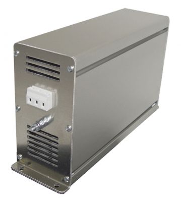

REO-USA offers the REO Sinus Filter Plus ++ to be used in any kind of application that requires safe mechanical continuous power and reliability. It enables suppressed interference not only on line cables to the motor, but also to earth conductors and feeds incurring bearing currents into the DC-link so that these may not cause any damage to the mechanical system. Water treatment – especially heat pumps – is one application example.

The conventional solution is to fit a low-pass filter at the output terminals of the frequency inverter, which reduces the differential-mode interference to a smooth sinusoidal waveform with a ripple content of less than five percent. However, this type of filter is inadequate for applications where the reliability of the motor is of upmost importance and where replacing the motor would come at a very high cost.
The solution is to use a conventional differential mode and a common-mode output filter. This helps eliminate bearing damage such as localized corrosion, caused by heat and pitting as a result of pulsing currents. Others benefits of using this combined solution include noise reduction, diminished current loses, reduction of radiated interference from cables, and prevention of hazardous voltages and leakage currents.
Sinus Filter Plus ++ in practice
REO has applied the above solution to protect the bearings of an underground pump motor, which is used in a combined geothermal and solar panel heating system. The problem here is that the cable running from the frequency inverter to the pump is very long and the water column provides a low impedance path back to ground. The resultant current pulsing through the motor bearings can create serious damage to the motor. Unfortunately, replacing or repairing the pump is a very costly project.
A REO Sinus Filter Plus ++ has been connected to the output terminals of the frequency inverter to reduce the common-mode disturbances that would otherwise cause premature bearing failure. The high-frequency interference causes the metering equipment to give inaccurate measurements, a problem also corrected by fitting the REO Sinus Filter Plus ++.
