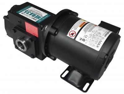

Regal's new drive solutions at Pack Expo include the 90% efficient Hub City HERA (high efficiency right angle) gear reducer, the lightweight aluminum Bravo and LeCentric reducers from Grove Gear, and Globetrotter induction motors (NEMA Premium) or SyMAX permanent magnet motors (designed to exceed NEMA Premium) from Marathon Motors. All can be combined in gearmotor packages for energy reductions of up to 40 percent, and SKU reductions up to 90%. Hub City HERA reducers with helical and hypoid steel gearing replace bronze worm gear drives. The design achieves 90% operating efficiency for all ratios. HERA drives reduce motor size requirements as well as the physical size of a drive package. They save up to $550 per year with each increment of horsepower for rapid payback. Available in four sizes, HERA drives are rated from 1,100 in-lbs. to 8,500 in-lbs. output torque.

Marathon Motors' SyMAX PMAC motors meet or exceed European IE4 efficiency levels, achieving efficiencies 25 to 35 percent higher than NEMA Premium and paying for the motor in as little as two years. The PMAC design is exceptionally power dense, which can result in a 2-3X frame size reduction. SyMAX PMAC motors minimize energy requirements with an optimized fan design, precision-wound stator, and elimination of rotor conductor losses. Capable of constant torque over a wide speed range, SyMAX PMAC motors can be combined with HERA reducers for gearmotors with double the torque density and a lower cost-to-torque ratio than standard systems. They are a drop-in replacement for induction motors, utilizing the same footprint, shaft height and other NEMA dimensions.
