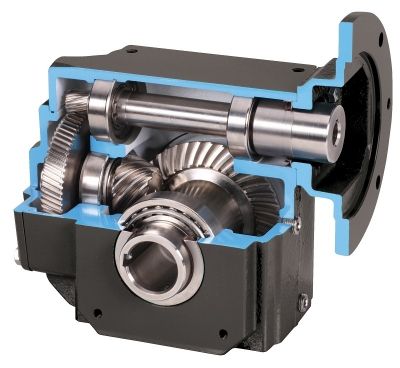

Quick-delivery shaft-mount and concentric reducers
Hub City's PowerTorque shaft-mount reducers will be displayed in cutaway to highlight the carburized and ground, AGMA 11 gears that provide exceptionally high torque density in a compact package, with up to 98.5 percent efficiency per stage. These versatile units are ideal value-priced drop-in replacements for applications such as bucket elevators and bulk conveyors. A wide range of accessories includes conversion kits for screw conveyor applications. Warranted for 18 months, they feature metal-reinforced double-lip seals riding on precision-ground shafts to deliver long service life. Ready for off-the-shelf delivery, PowerTorque reducers are available in 10 sizes up to 200 hp rating, with output speeds to 200 rpm.
