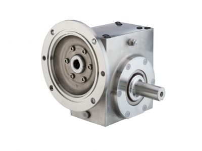

Regal Beloit Corporation has announced that its Grove Gear Stainless Steel Worm Gear Reducer has achieved third party IP69K certification.

This Grove Gear Stainless Steel Worm Gear Reducer has a 316 stainless steel housing to withstand extreme environments. An O-ring on the face of the motor adapter, poppet-style vent, and v-rings on the output shaft seals provide a system that fights dust and moisture intrusion. A 303 stainless steel output shaft and stainless-steel hardware are also included.
This reducer is also available with Leeson motors pre-assembled for the perfect performance-matched and IP69K-certified solution.
