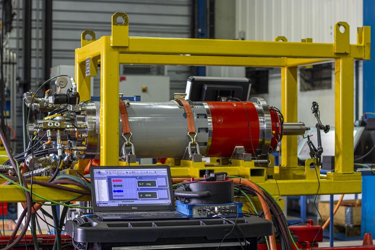

Redex can recount numerous examples of designing and implementing solutions built according to the specific requirements of individual machine tool builders. All of the company’s solutions are subject to rigorous systematic testing protocols, running tests with full temperature checks and verification of nominal gearbox ratings. REDEX has even developed modeling systems using digital twins in support of accurate simulations.
First-rate performance
The nominal ratings of planetary gearboxes result from theoretical bearing and gear capacities according to the load level at several different speeds, as well as the calculated service life. Redex design engineers have developed a numerical model capable of predicting the operating temperature of gearboxes, specifically their thermal behavior and efficiency. This model enables the extrapolation of a torque curve corresponding to the constant (thermal) power of the system in a given configuration. An intensive testing program involving the Redex RP series of high-precision planetary gearboxes demonstrated the correlation between theoretical and experimental data.
