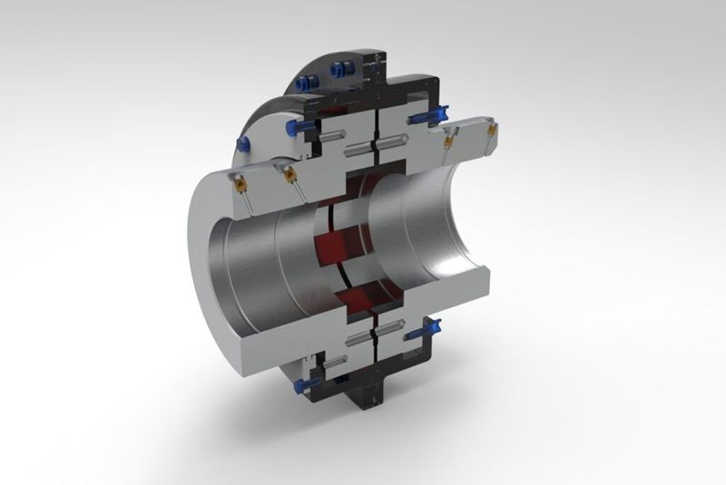

The Quick Flex couplings from Lovejoy, manufactured by R+L Hydraulics in Werdohl, are now optionally available with seals that prevent the ingress of dirt and dust in particularly critical areas of application. In addition to the sealed version, the couplings are also available in an Ultratemp version for temperatures up to 177 °C. The couplings are available with shortened hubs for confined installation spaces.
In contrast to other frequently used solutions, the Quick Flex coupling does not require any oil or grease, so there is no need for checking or relubrication.
High damping and reliable torque transmission
Four elastomer elements in three degrees of hardness are available for the Quick Flex couplings, enabling both high damping and reliable torque transmission. The couplings cover continuous torques from 43 Nm to 902.5 kNm and peak torques up to 1,800 kNm. They are available with bore diameters from 10 mm to 500 mm and with or without spacers for shaft distances from 25 mm to 3,000 mm. Different bore types and designs can be realized individually.
Elastomer couplings for harsh environmental conditions
Elastomer couplings are used for power transmission in drive systems. They reduce the load on surrounding components such as roller bearings and dampen shocks that occur during operation and stress the entire drive train. The Quick Flex series was specially designed for harsh environmental conditions, such as those found in steel and metal works, lime kilns, crushers and mills in mining, sawmills and similar applications.
