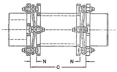

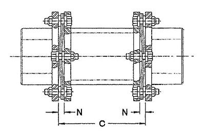

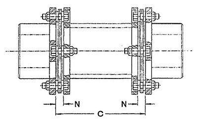

  4. The disk pack is wavy and the dimension “N” between flange faces is smaller than indicated on the installation instructions or applicable assembly drawing as shown in Figure 2. The coupling has been installed in a compressed condition or equipment has shifted axially during operation. Check for thermal growth problems. If the application has a sleeve-bearing motor, make sure that the operating centerline of the motor rotor is properly positioned. Realign the axial position of the equipment to relieve disk pack compression during operation.
  5. Figure 2: The disk pack is wavy and the dimension “N” between flange faces is smaller than indicated on the installation instructions or applicable assembly drawing.
  6. The disk pack is wavy and the dimension “N” between flange faces is larger than indicated on the installation instructions or applicable assembly drawing as shown in Figure 3. The coupling has been installed in an elongated condition or equipment has shifted axially during operation. Realign the axial position of the equipment so that the coupling operates with a neutral flat disk pack. If the application has a sleeve-bearing motor, make sure that the operating centerline of the motor rotor is properly positioned.

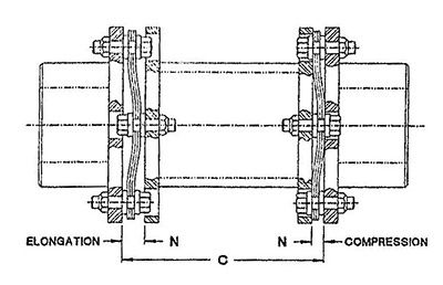

  8. Wavy disk packs on both ends of the coupling. One end is compressed, and the other is elongated. See Figure 4. This is called “oil canned” disk packs. The disk pack has no neutral center where it remains flat and parallel with the end flanges. Loosen all locknuts, correct the axial spacing, and tighten the locknuts. If this doesn’t resolve the problem, the disk packs might have been permanently deformed. Replace the disk packs and reassemble the coupling.
  9. Figure 4: Wavy disk packs on both ends of the coupling. One end is compressed, and the other is elongated.

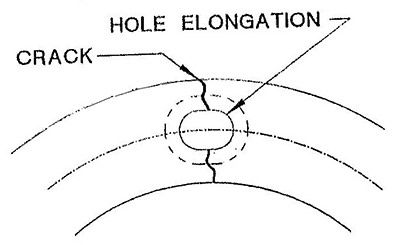

  1. The disk is broken through the bolt hole as shown in Figure 5. This indicates loose coupling bolts. Replace the disk pack and tighten locknuts to the specified torque.
  2. Figure 5: The disk is broken through the bolt hole.

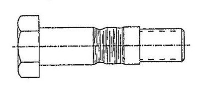

  3. Disks are embedded in the bolt body. This is usually the result of a loose bolt or severe torque overloads. This can also appear when turning the bolt during installation. Replace the bolt and tighten the locknut to the specified torque. Do not turn the bolt during the locknut tightening process. See Figure 6.
  4. Figure 6: Do not turn the bolt during the locknut tightening process.

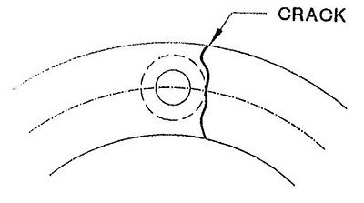

  5. Disk is broken adjacent to washer face. Cracks usually start in the outermost disk and progress through the disk pack. This indicates excessive misalignment during operation. See Figure 7. Replace both disk packs and realign the equipment. Make a hot check of alignment to ensure it is within the coupling specification.
  6. Figure 7: Excessive misalignment during operation.

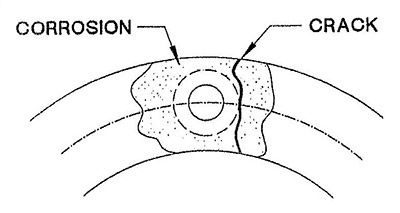

  7. Disk is broken adjacent to washer face with fretting corrosion in the area of the crack. This indicates excessive misalignment during operation. See Figure 8. Replace both disk packs and realign the equipment. Make a hot check of alignment to ensure it is within the coupling specification.
  8. Figure 8: Disk is broken adjacent to washer face with fretting corrosion in the area of the crack. This indicates excessive misalignment during operation.
