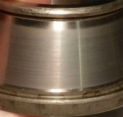

So back to the two camps of particles; we have small and we have large particles. I know — they aren’t “thaaat” large; but what we are talking about are particles that are large enough to create a small stress riser in the surface — which can lead to spall. These particles create dents that are large enough to see. If you made me draw a line in the sand between large and small particles, it would be around 50 microns. You can see in Figure 1 that these dents are quite large — well over 200-300 microns. This type of denting usually comes from something else actually failing. That “something” is often another bearing or some type of external contamination. The debris created by a gear mesh is much finer than this. Gear wear particles are closer to 10-30 microns. Those can still be troublesome if they are in heavy enough concentration, but unlike this visible denting, small debris creates a wear mechanism. Certain wear mechanisms can be a problem for some ball bearing applications, particularly for angular contact bearings that are preloaded and under heavy loads. The particles tend to concentrate in the center of the raceway and can eventually start degrading the surface and lead to premature failures.

You will not find any shortage of information meticulously breaking down the specific amount of contamination to bearing life degradation; use some caution with that. I have found many instances where new oil had more contamination than the recommended operating condition. All you can really do is run it and see how it does. If you are seeing raceways like I have (Fig. 2), then you are likely generating a lot of particles. But that in itself doesn’t mean your system is doomed to failure. The good news is that aluminum is very soft compared to bearing steel and other common wear mechanisms we see in our systems such as gear steel and external contaminants like the fine Middle Eastern sand (Fig. 2). In the unlikely event that you do start seeing early failures, (which I doubt you will), almost all of the top bearing companies offer some sort of debrisresistant bearings. These usually involve some sort of additional surface hardening. There is quite a difference in performance/contamination between a typical 60 HRC bearing and a premium 65’ish HRC bearing. Either way — I wouldn’t lose any sleep over this application.
Figure 2 Warranty return from the Middle East.
