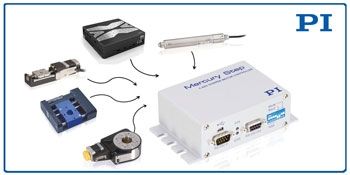

PI (Physik Instrumente) has released a higher performance model of its successful Mercury Stepper Motion controller. Stepper motors take up discrete positions in a revolution of a constant distance. Typical commercial models provide 200 to 1000 full steps per revolution. Designed to deliver more than 2,000 times the basic motor resolution, the C-663.12 Mercury controller is the newest addition to PI’s suite of motion control solutions.
PI’s compact C-663.12 motion controller is designed for 2-phase stepper motors, in open-loop or closed-loop operation commanded by USB or RS-232. Up to 16 units can be combined via daisy chain to operate multi-axis motion systems. The Mercury controller includes a 48-V wide-range-input power supply, and all cables required for operation. Programmable digital and analog I/O lines and input lines for limit and reference point switches controlled via TTL signals are also integrated.
The C-663.12 is equipped with a data recorder for high speed tracing, ID chip compatibility for quick start-up and on-the-fly parameter changes, and exchange of system components without recalibration. The controllers are delivered with extensive software packages, including drivers for LabVIEW, as well as dynamic libraries for Windows and Linux.
