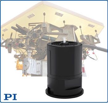

High atop the Cerro Armazones in the harsh but extremely dry environment of the Chilean Atacama Desert, more than 2000 custom hybrid actuators will adjust 798 quarter ton segments in the primary mirror of the Extremely Large Telescope (ELT). As a leader in precision motion control solutions, PI (Physik Instrumente) designed a new type of actuator that would meet the extreme requirements and win the European South Observatory (ESO) contract.
Hybrid Actuator Concept Solves the Nanometer Precision - High Load - Low Heat Conundrum  PI’s ultra-precision actuator was developed to meet requirements such as: tracing performance better than 2 nm RMS, force variation 0 to 900 N, 15 mm travel, minimized heat dissipation. Several concepts were simulated and tested before a winner was picked. The best results were achieved with a hybrid design based on the combination of piezo actuator, brushless motor, linear encoder and a hybrid controller to drive both the brushless motor and piezo actuator simultaneously based on the position feedback of an optical position sensor providing sub-nanometer resolution. Three actuators are required per segment.
Why is this Precision Required? In order to perform similar to one 39 m mirror (it is not feasible to make a single mirror of that size), all segments have to be aligned to each other to within nanometers all the time. The exact position of the mirror segments is influenced by several factors such as wind load, distortions, and vibration from the telescope structure, temperature fluctuations and varying gravity effects during tracking motions of the telescope. Smallest alignment errors between the mirror segments will degrade the optical performance of the telescope.
