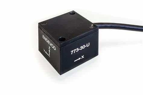

PCB Introduces Latest Triaxial Angular Rate Sensor
PCB Piezotronics (PCB) is introducing the new Endevco Model 7330 triaxial angular rate sensor. It provides accurate measurement of rotational velocity in a small, lightweight package rugged enough for extreme environments, such as automotive safety testing. Model 7330 has full scale angular rate ranges including ±100, ±500, ±1500, ±6000, ±8000, ±12000 and ±18000 deg/sec, and provides full scale voltage output of ±2V. Designed for automotive rollover and safety testing, this sensor also excels in a wide variety of shock and vibratory motion applications, including helmet, sports, and aerospace testing.
