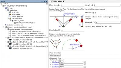

Not only does it support the PLCOpen environment, but PAM comes packed with tools such as the CAM table editor, CNC capabilities using .dxf to G-code converters, graphical motion path editing, and pre-made inverse kinematic function blocks for robotics such as delta and H-bots, SCARA, and gantry systems. With the latest update of PAM 1.3, users can now utilize the Kinematics Helper, a visual wizard that helps users walk through configuring complex robotics in a visual, point-and-click environment that takes the complexity out of robotics control. With the addition of PLCOpen4 support, programmers can now take advantage of Machine (or Robot), Part, and World coordinate systems. This means the developer creates an entire factory line, complete with multiple robotics, and track the orientation of a part—all in a single control system and programming environment. This significantly reduces project complexity, eliminating the need to have multiple sub-systems communicate, as control is completely centralized in the PAC.
