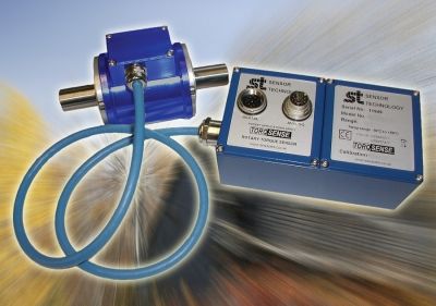

For the Oxford YASA Motors application, a type RWT321 sensor with integral electronics was chosen. Like all TorqSense sensors, this combines high accuracy and resolution with a large overload capacity and the ability to operate equally well with clockwise and anti-clockwise rotation. In addition to torque data, the sensor also provides information about shaft speed, power and temperature, with all of the data made available in real time.
A further benefit for Oxford YASA Motors is that the RWT321 incorporates a CANopen interface. This is directly compatible with the company’s data acquisition and analysis systems and, therefore, made interfacing the sensor very straightforward.
