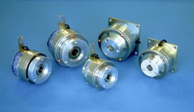

Ogura Industrial is pleased to announce a new addition to our product line.  Although the AMC and AMB series are not new, they have gone through significant design improvements.  Because of these improvements, the AMC/AMB-E series is finding new opportunities for machinery manufacturers in North America because of some of its unique features.
The new E series is available in four sizes, 2.5, 5, 10, and 20.  These have been redesigned to have approximately a 25% increase in torque, a 5% reduction in power consumption, approximately a 15% lighter weight while also being roHs compliant and having a lower cost.  These increases in performance and lower cost have been achieved by optimizing the coil, housing and rotor design to achieve a more efficient flux path.
