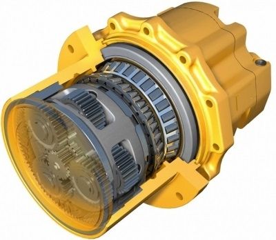

Oerlikon Graziano has invested in key technologies for cylindrical gears and grinding superfinishing, to reduce noise emission and improve power transmission of the gears in the driveline. Superfinishing uses one single grinding worm for the whole tooth grinding, but the wheel is divided in two zones with different specifications, dressable with the same dressing roll. The additional superfinishing stroke reduces the peaks of the roughness without changing the flank topography allowing to achieve a surface roughness of Ra < 0,20 μm.
The process is absolutely repeatable and adaptive to every gear and OEM need. Main benefit, in addition to noise reduction, is an increased gear load capacity, more power input and less fuel consumption without changing the original transmission design. Highlights from the exhibition included a selection of Shifting Solutions for the Agricultural market, including the new Compact Slotless Synchronizer, clutch packs, a power take off (PTO) with hydraulic shifting, bevel sets, cylindrical gearing solutions, high-tech torque-hub planetary drive, the Champion series of drives and more.
