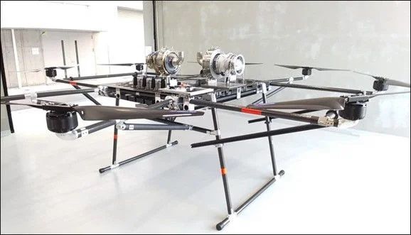

NSK Ltd. has released a new gas turbine generator bearing for eVTOLs including large drones, which is expected to extend drone flight range. The new product was used for the gas turbine generator of a large drone (high payload emergency supply delivery drone equipped with a gas turbine generator) equipped with an 80-kw hybrid drive system for a regional reconstruction and practical development promotion project in fiscal 2023 and delivered to Fukushima Prefecture on February 21, 2024.
