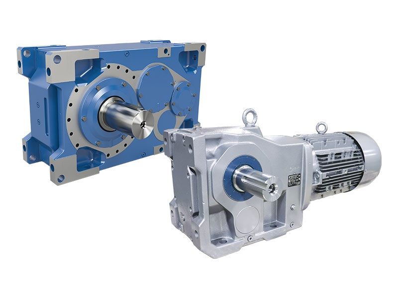

MAXXDRIVE Industrial Gear Units
MAXXDRIVE Industrial Gear Units were designed to fit the needs of heavy-duty applications such as bucket elevators, agitators, and drag conveyors. They are made from one-piece UNICASE housings to ensure high load capacity, long service life, and quiet operation. MAXXDRIVES are configurable with a variety of sealing options, bearings, and cooling and heating options so they can be easily adapted to a wide range of ambient conditions. These durable units are available in parallel shaft, right-angle, and MAXXDRIVE XT right-angle housing designs. The XT right-angle gearboxes provide the grain industry with a symmetrical design for mirror image installations, optimized thermal ratings, and effective fan cooling. MAXXDRIVE industrial gear units also have the option of adding NORD’s Grain Endurance Package. This package consists of several protective measures to ensure a long operation life including a drying agent filter, an oil sampling port, a quick fit filter trolley connection, oil inspection glass, and oil drain cock.
90.1 Helical Bevel Units
Helical bevel gearmotors are made from one-piece UNICASE housings and provide reliable operation, low maintenance, and long service life. These versatile units offer exceptional flexibility with 11 different case sizes, a wide performance range, and various mounting and shaft options to choose from. The 90.1 helical bevel gearboxes also feature infinite life gearing, high axial and radial load capacity, minimum backlash, and heavy-duty bearings.
