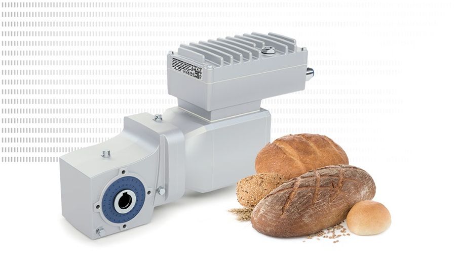

Smooth Surface Gearmotors for Washdown Protection
Nord offers a range of smooth surface drives made from high-strength, naturally corrosion resistant aluminum alloy designed for easy cleaning in washdown environments. The housings have no external hard edges or crevices, ensuring particles and liquids can drain off in any installation position and there are no areas where corrosive liquids can remain. Smooth surface gear unit designs include Nordbloc.1 helical inline gear units, Unicase parallel shaft gear units, Nordbloc.1 helical bevel gear units, and Universal SMI worm gear units. All gear units are available with NEMA/IEC adapters or direct mounting and feature precise seals that prevent contaminants from entering the housing. Nord’s smooth surface motors include both IE3 asynchronous and IE5+ synchronous versions, both of which do not include cooling fins or fans, preventing contaminant accumulation and germ spread via air flow. Additional motor protection options include potted terminal boxes, condensation drain holes, space heaters, and moisture resistant varnished dipped windings.
