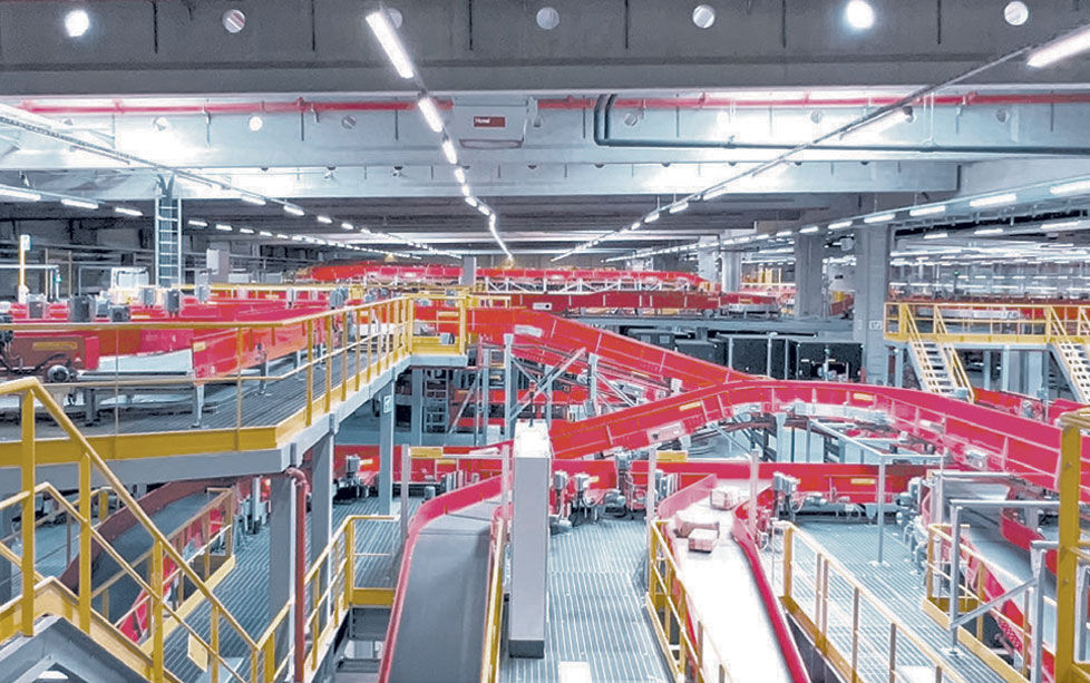

Nord supports the post and parcel industry with high-efficiency drive solutions optimized for reliable, low-maintenance operation. Standardized LogiDrive complete drive solutions are often selected for these applications as they provide a gear unit, motor, and variable frequency drive that can be configured to meet precise specifications. Their modular design incorporates Plug-and-Play technology for easy installation and enables all components of the drive to be individually serviced, minimizing maintenance, downtime, and repair costs. Sorters, belt conveyors, curved conveyors, and lifters employ two-stage Nordbloc.1 helical bevel gear units paired with IE4 or IE5+ permanent magnet synchronous motors and Nordac Link variable frequency drives, while merger applications use Unicase helical inline gear units to accommodate their particularly high dynamics and speeds. Both compact solutions provide high-efficiency, fast ramp times, smooth automation, long service life, and quiet operation.
