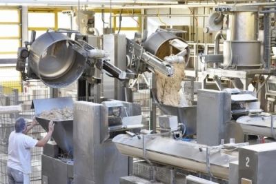

NORD DRIVESYSTEMS offers efficient and hygienic drive solutions for the baking industry, meeting their special requirements for hygiene, reliability, and robustness. This includes agitators, conveyor systems, weighing and filling plants, packaging machinery, and more. NORD’s variable frequency drive technology guarantees high positioning accuracy and safe implementation of dynamic sequences. The drive units can also be controlled individually, for example, they can regulate kneading and conveyer speeds in order to prevent blockages or control the dough process. Due to their modular structure, NORD drive units are also service and maintenance friendly. For the baking industry, addition of the nsd tupH sealed surface conversion treatment provides an outstanding anti-corrosion treatment for gear units, smooth surface motors, variable frequency drives, and motor starters with cast aluminum housings for extra protection in washdown environments. The fan-less smooth surface motors do not spread germs and operate with very low noise.
