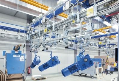

More than 100 drives take over various tasks in the new facility – Nord drive technology powers conveyors, hoists, exhaust ventilation and cooling fan systems. Drawing on its own modular drive program, Nord has configured optimal solutions for each of the various requirements. Both highly efficient helical bevel gear units and worm gearboxes with very high gear ratios are used. Depending on the performance and function requirements, the motors are controlled by different frequency inverter models.

The Nord motors and gear units passing through this facility often weigh several hundred kilograms. Robust hardware is therefore required. The overhead conveyor is operated at a maximum speed of 10 m/min. It is equipped with over 100 smooth-running worm geared motors. Some parts of the facility are classified hazardous areas (Ex zone 2). The 14 drives installed within them are controlled by SK 500E series cabinet-installed inverters. All other drives feature a motor-mounted SK 180E type inverter. Designed to achieve a great price/performance ratio while offering a full complement of efficiency functions, the SK 180E supports motor outputs from 0.25 to 2.2 kW to address all simple handling tasks in horizontal applications. A technology box installed with the inverter adds a Profibus interface as well as various sensor and pneumatic interfaces for transmission of position data and controlling switches. The integrated drive configuration capability as well as the consistent use of plug connectors was instrumental in minimizing the drive installation effort in the extensive facility. The AC vector drives have a separate 24 V control voltage supply and can therefore be accessed via Profibus even when the 400 V power supply is switched off.
