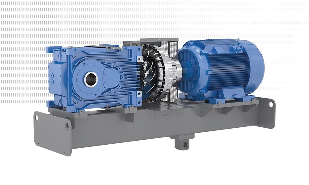

Nord Drivesystems provides a comprehensive product portfolio of heavy-duty drive solutions engineered to withstand the extreme rigors of the mining and bulk material handling industry. Central to their offering is the MaxxDrive industrial gear unit series (pictured above) which delivers high output torques up to 2,495,900 lb.-in., making them ideal for high-capacity applications such as crushers, mills, and conveyors. By pairing these robust units with energy-efficient motors (up to IE5+) and intelligent variable frequency drives, Nord provides a fully integrated, modular system that maximizes throughput while significantly reducing energy consumption and maintenance downtime.
MaxxDrive industrial gear units provide the high torque and rugged durability required for the extreme environments of the Mining Industry. These units are typically engineered into large-scale conveyor systems, bucket elevators, winches, and crushers where they manage the high starting loads and continuous operation necessary for transporting heavy raw materials. The MaxxDrive series is designed with a one-piece Unicase housing that ensures high structural rigidity and leak protection to withstand the temperature fluctuations and abrasive dust common in mining environments. The gear units can be equipped with cooling systems, such as axial fans or internal cooling coils, to maintain thermal stability during high-load processing,
effectively minimizing downtime and extending the service life of the system. Many options common for mining systems are also available including elastic input couplings, disc/drum brakes, axial fans, swing bases, auxiliary drives, oil coolers/oil heaters, splash lubrication, and more.
Two-stage MaxxDrive XT industrial gear units utilize a special ribbed Unicase housing with an enhanced axial fan design that maximizes thermal power limits, often eliminating the need for external cooling in harsh, high-temperature environments. Large roller bearings and center distances increase the load capacity for consistent, safe operation of systems. Mirror-image installation is also possible via the symmetrical design, effectively reducing the number of replacement gear units and administrative expenses. A wide range of options including couplings, brakes, backstops, and motor attachments are additionally available to meet system needs.
