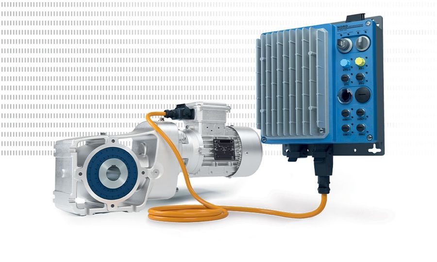

Photo caption: Nordac Link variable frequency drives provide a convenient drive solution for decentralized installations as the flexible configuration enables precise adjustment of the devices to a wide range of applications. (Image: Nord Drivesystems)
