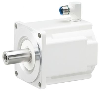

Compared to traditional mostly pneumatic-driven lifting units, the new lines of R2XX to R5XX machines utilize a motor-gearbox combination to deep draw and seal the foil. These units utilize a knee lever mechanism to lift the molding tools – some weighing several hundred kilograms. They withstand the high bonding pressure of up to 20 tons, ensuring the two foils seal securely. Being a strategic motion control partner for Multivac, Kollmorgen implemented a compact unit consisting of an AKM servomotor and a cycloidal gear drive for the lifting axis. Kollmorgen calculated and selected the optimal motor size and gear drive type in close cooperation with Multivac’s engineering development teams.
Two important aspects for the drivetrain selection were the overall unit length and overload capacity. The model HKS03 six-point lift unit features a servo gear motor with brake having a total length of 307 mm and an acceleration torque of 1400 Nm. These results are possible thanks to the high power density of the AKM servo motors, the ideal overall length of the cycloidal gear drive and the fact that the unit comes without end bells and clutches. Piston rods convert the rotary to linear lifting motion. This solution has three significant advantages. Firstly, the energy efficiency of the machine increases because the pneumatic system was replaced as the power source to create the required pressure for the deep draw and sealing operation. Secondly, the geometry of the piston rods creates an extreme closing force at the end of travel which improves food safety. Finally, the high sealing force results in a more secure and thus reliable sealing process.
The two-component epoxy coat used for the hygienic design conforms with FDA 21 CFR 175.300 and is resistant against acids, bases and established cleaning agents with a pH range of 2 to 12. In a long term test performed by the company EcoLab, this coat withstood exposure to an equivalent of more than 2,000 washdown cycles including disinfecting treatments. Kollmorgen’s washdown gear motor comes standard with a white coating, significantly improving the machine operators’ ability to detect dirt and biofilms on the surface during cleaning operations.
