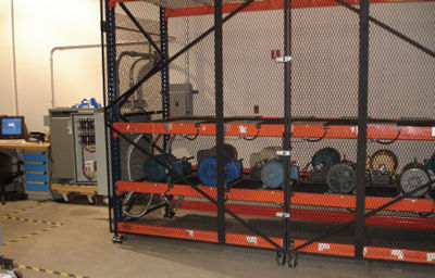

Motor reliability test bed.
Single-phase induction motors often develop problems with the starting circuit components (which are more susceptible to failure than other motor components). An endurance test in this case might involve rapidly cycling the motor on and off under load, causing severe stress, inrush current and severe electromechanical forces. The rapid cycling can also overheat the motor windings and bearings, accelerating motor failure. This is an example of how endurance tests are designed so that failure mechanisms of interest are accelerated.

With five motors from each supplier (10 total) in hand, the Advanced Energy team went to work building a test rig and devising a control mechanism to test for motor reliability. There were many issues to be addressed to get 300,000 start/stop cycles within an acceptable time frame: the motors needed to be loaded; they needed to come up to speed to engage the capacitor switch and stop again so they could be restarted quickly; a system for control and remote monitoring needed to be established, as testing was continuous, seven days a week; and temperature rise from rapid starting and stopping needed to be monitored and minimized as a variable due to the accelerated life cycle testing each motor was being subjected to.
After 10 weeks of testing, the OEM now has the information needed to make an informed decision. Its team members have specified to the winning supplier the exact design they will need. And to be on the safe side, they are bringing back more of these motors for further reliability testing in the lab.
