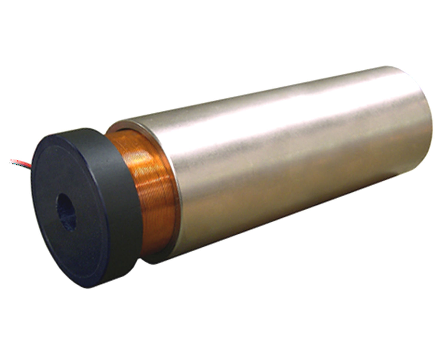

Moticont Updates Linear Voice Coil Servomotor Line
Moticont is releasing two 12.7 mm (0.500 in.) diameter Linear Voice Coil Motors, the LVCM-013-032-02M (Metric) and the LVCM-013-032-02 (Imperial). These brushless high speed linear servomotors have a 25.4 mm 1.000 in. long stroke, and a high-force-to-size ratio of 0.70 N (2.5 oz.) and a peak force of 2.20 N (7.9 oz.) at 10% duty cycle.  Known also as moving coil motors or linear actuators they are ideal for:  Dispensing, work holding and clamping, assembly, testing, wafer handling, animation, dynamic vibration absorption, scanners and laser beam steering and filtering. Featuring low inertia and high acceleration/deceleration they are: Clean, quiet, efficient, and have high accuracy and high repeatability when operated in a closed loop as a DC servomotor.
