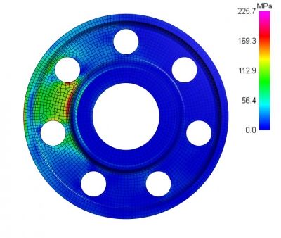

For 3D-elastic parts an orthotropic material can be defined for shafts now and an evaluation of surface stresses has been added. On geometry import as mesh, multiple materials can be used for one part. Additional possibilities for contact between two 3D-elastic shaft have been added. Now displacements, tilting angles and reaction forces are reported for all condensation points. For geometry import as STEP a preview dialog was added, allowing deleting or merging of parts or remeshing with different settings.
