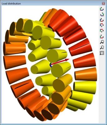

The bearing analysis software allows the calculation of bearing load distribution and bearing life according ISO/TS 16281 and is integrated in a shaft system calculation with additional possibilities like strength calculation for shafts, modal analysis and interfaces to gear calculation programs.

In addition to the shaft and rolling bearing calculation software a new calculation of load distribution for ball screws is available now. Life is calculated from load distribution analogously to ISO/TS 16281. This allows the consideration of radial and moment loads in addition to axial loads. As in the other programs, an automatic parameter variation is available as well.
