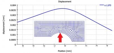

If a bearing ring of an angular contact ball bearing is mounted with clearance and pretension is applied the ring can expand until it makes contact with the housing. This affects the stiffness of the bearing. This effect is now considered by a simplified approach on the basis of thick ring theory. The elastic expansion of a ring under pressure is considered on bearing clearance. The calculation currently uses Dpw+Dw as inner diameter for the outer ring without consideration of the shoulders and allows an additional stiffness factor as input. So without the stiffness factor the ring will be too soft in the calculation and the expansion will be a little too large.
The attached image shows a comparison for one example. The bearing calculation uses an expansion of 3.86 μm while an axisymmetric FEA would lead to a maximum value of 3.68 μm. So the stiffness factor could be chosen to 1.049 to correct this error. Taking into account that all parameters have tolerances an error below 1 μm could be ignored in most cases.
