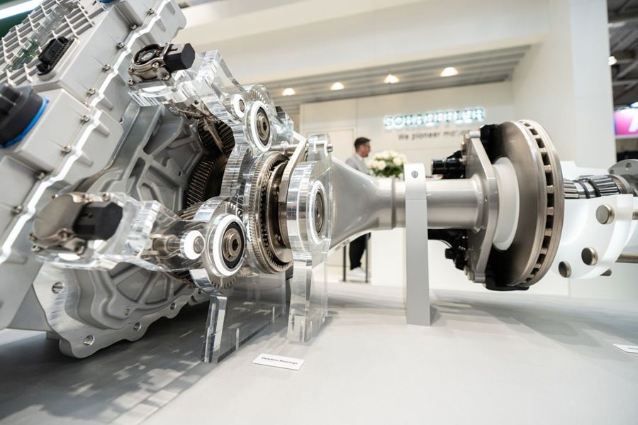

Schaeffler's innovative and reliable solutions for the agricultural industry including highly efficient electric traction motors, new EWELLIX electromechanical linear actuators, and friction-reduced rolling bearings – including the tillage bearing system "Schaeffler Field Pro". Schaeffler now offers a total of four series: the modular EWELLIX linear actuators CAHB10, CAHB2x with rated forces of 1.5 and 10 kN, the new EWELLIX platform EMA-80 up to 31 kN, and the EMA-100 series up to 60 kN. With the new design, the modularity was extended – down to the base component level of the screw drive, gearbox, motor, and mounting. Within any given EWELLIX linear actuator EMA-80, the customer can individually select their components. This allows for the attachment of a preferred motor type or the connection to an existing control system, which can significantly reduce design and programming costs. As standard, highly efficient asynchronous and synchronous motors with peak outputs of up to 5 kW are used. The b-side brake in the motor is used as a static holding brake and prevents undesired movements (also in the event of a power outage). Optionally, the speed can be limited with a centrifugal brake and the load safely lowered even without a power supply. The motor is either attached directly onto the actuator (inline) or a 2- or 3-stage spur gearbox with ratios of 4, 10, 12, 20 is mounted in between to achieve a parallel arrangement. As an optional accessory, a multiturn absolute position sensor or a redundant brake can be attached to the gearbox. Schaeffler also presented its highly efficient heavy-duty electric motors as a complete motor family with continuous outputs of 110 to 220 kW and peak outputs of 140 to 310 kW. The independent power electronics feature a four-quadrant drive controller, allowing braking energy to be recovered from the traction motor in overrun mode. Electric motors can also be used as highly efficient generators in combination with diesel engines and then provide the electrical energy for the traction drives. Due to the compact external dimensions, electric motors can also be used as electric PTOs (ePTOs). Independent of the powertrain and able to be positioned anywhere, they offer an especially high degree of design freedom.

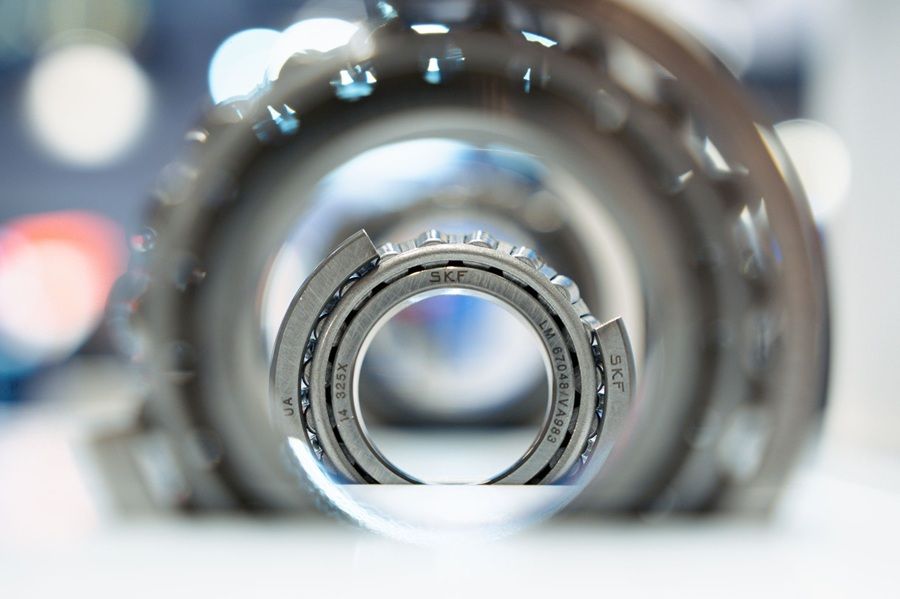

SKF’s latest innovations in bearings, lubrication systems, and seals designed for the toughest agricultural conditions. Visitors saw how advanced Agri Hubs, proven sealing solutions, and smart lubrication tools can help boost productivity and reduce downtime. The new Agri Hub T400 for disc harrows, developed in close collaboration with agricultural practitioners — practically “in the field.” What sets it apart from conventional bearing units is its four-times more effective sealing system against contamination. Specifically designed for the most labor-intensive weeks of the year, it has successfully completed a 10,500-hour endurance test and significantly reduces maintenance requirements in agricultural operations. Also designed for longer service life in demanding agricultural environments are the SKF DuraPro deep groove ball bearings for tractor drivetrains. Compared to the popular Explorer-class bearings, they offer minimum twice the lifespan and 20% higher load capacity, thanks to a special hardening method and surface treatment. Other bearing solutions SKF will showcase at Agritechnica 2025 include proven pre-lubricated and sealed deep groove ball bearings, sealed spherical roller bearings for highly contaminated environments and idler sprocket units.
