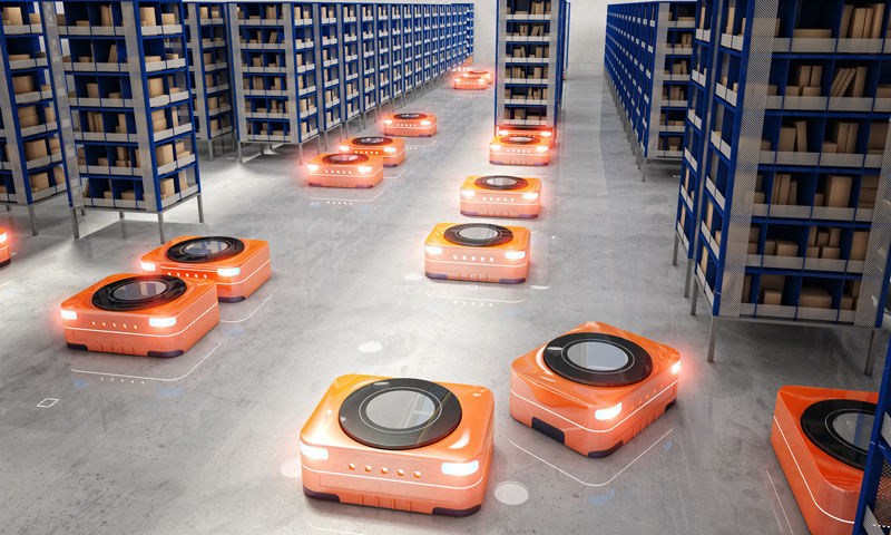

Driverless transport systems have proven to be extremely economical and productive. For example, they are used to distribute goods that are picked in large storage and freight forwarding halls. The vehicles—often referred to as Automatic Guided Vehicles (AGVs)—are also used to transport individual parts and prefabricated components into processing stations in assembly and production halls. They usually work autonomously, using sophisticated sensor technology to orient themselves within their environment. Their routes and destinations are programmed and stored in a built-in computer, and the electric power for the driving motor is provided by rechargeable batteries carried in the vehicle.
Compact vehicles ensure a long useful life
AGVs are particularly productive and economical if they can complete long distances and operating periods without repeated recharging of their batteries. This places special demands on their design and construction. In particular, the vehicles and components installed therein must be lightweight and compact. Especially, the AGV manufacturers require high power density and energy efficiency from the drive system. As a further problem, the increasingly smaller shuttle vehicles used for distribution systems in warehouses contain little available space for these drives. This means that the standard drive units with axially arranged electric motors and multi-stage spur gears and planetary gears cannot be installed due to their overall length.
With unattended operation around the clock, driverless
transport systems (AGVs) in warehouses, parcel distribution
centers and production halls ensure maximum profitability
and reliability when distributing goods, packaging materials
or components (photo courtesy of Framo Morat).
With unattended operation around the clock, driverless transport systems (AGVs) in warehouses, parcel distribution centers and production halls ensure maximum profitability and reliability when distributing goods, packaging materials or components (photo courtesy of Framo Morat).

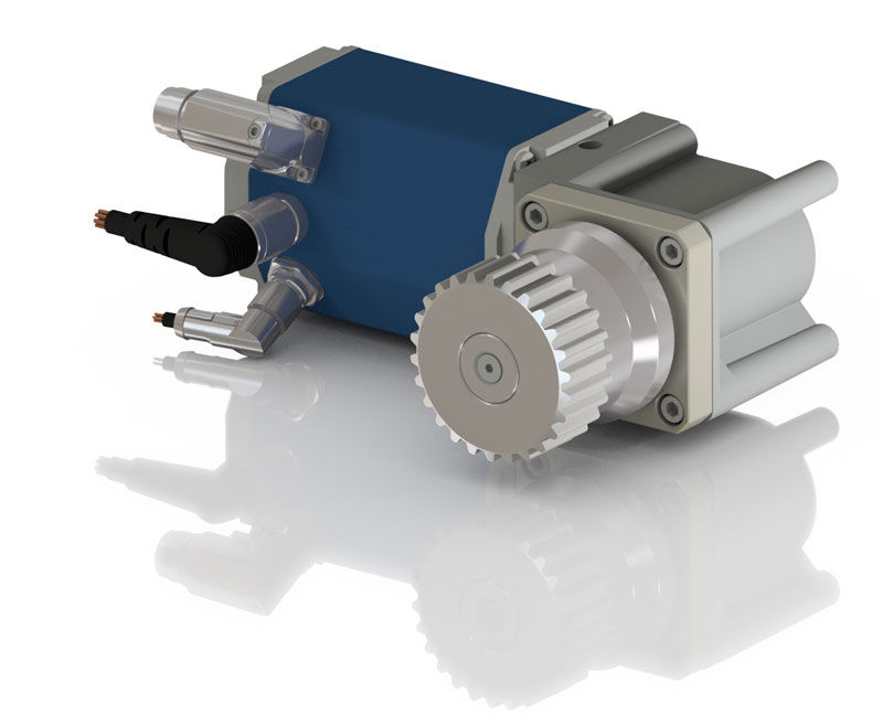

Thanks to their compact design and high efficiency,
drive systems consisting of DC motors as well as
bevel gears and hub gears are beneficial for mobile
applications (photo courtesy of Dunkermotoren).
Thanks to their compact design and high efficiency, drive systems consisting of DC motors as well as bevel gears and hub gears are beneficial for mobile applications (photo courtesy of Dunkermotoren).

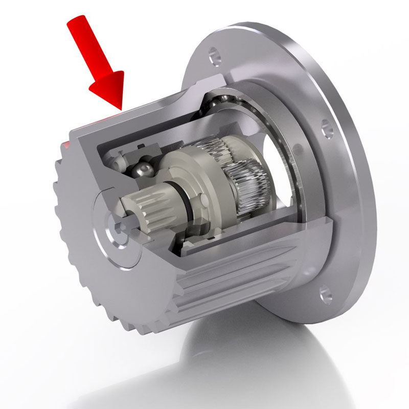

Compact design easily handles large radial forces
The newly developed hub gears use standard ball bearings to absorb the high radial loads. “The designation of this gearbox design provides an insight into its special design features. The entire gearbox can be accommodated inside a narrow wheel hub,” reports Sühling. In this gearbox type, the drive shaft and output shaft are arranged coaxially, one inside the other. The radial forces are distributed almost centrally between the two ball bearings via the hollow shaft. The small clearance between the ball bearings has a positive effect on the bending stiffness of the hollow output shaft, which scarcely bends at all.
A planetary gearbox transmits the torques between the drive and the output shaft. It provides the required transmission ratios for the speeds between the drive and the output side. For the attached electronically controlled DC motors from Dunkermotoren, these are usually between i = 20 and i = 30. And because the planetary carrier is only inclined to an insignificant degree, the gearbox runs extremely quietly.
Hub gears from Framo Morat prove their value
as wheel drives for AGVs due to the advantageous
arrangement of both the bearings and the drive and
output shafts (photo courtesy of Framo Morat).
Hub gears from Framo Morat prove their value as wheel drives for AGVs due to the advantageous arrangement of both the bearings and the drive and output shafts (photo courtesy of Framo Morat).
In order to make the entire drive package particularly compact, a bevel gearbox connects the DC motor to the input shaft of the hub gears. “With this combination, we can achieve the smallest installation space with the maximum energy density,” emphasizes Stefan Tröndle, product manager at Dunkermotoren in Bonndorf. “The combination of our brushless, electronically controlled DC motors with over 90 percent efficiency and the very light, low-loss bevel and planetary gearboxes enable us to achieve very high efficiency for the entire drive system and thus high energy efficiency. This innovative drive system plays a decisive role in making the shuttle vehicles particularly cost-effective,” adds Tröndle.

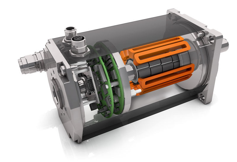

The electronics integrated into the DC motor enable
the drive systems to be networked via different fieldbus
systems (photo courtesy of Dunkermotoren).
The electronics integrated into the DC motor enable the drive systems to be networked via different fieldbus systems (photo courtesy of Dunkermotoren).
For this purpose, Dunkermotoren provides electronically commutated DC motors from its BG series. Depending on the model, they operate with 10 V to 60 V DC. With a 24 V supply voltage, they can provide a permanent drive power of 1100 W and can reach a maximum of 2600 W for short periods. In addition to models with integrated commutation, versions with built-in speed control or positioning electronics are also available. The integrated electronics allow, for example, complete driving profiles to be stored and retrieved. The CANopen, Profibus or EtherCAT bus systems provide data communication with higher-level controllers. As a modular component, Dunkermotoren offers suitable brakes for the respective motor size. As an option, the motor manufacturer can implement Safe-Torque-Off (STO) via software and the motor control. This ensures safe operation of the drives and helps to avoid hazards for personnel and equipment in critical situations.
