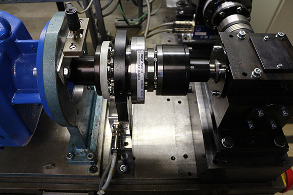

“In the tests, the efficiency is determined by means of performance difference measurement at the input and output of the test gear unit,” added Norgauer. “For accurate measurement results, the connection of the gear shafts and the measuring shafts used is of particular importance. The measuring shafts must be bearing-supported free of parasitic forces to achieve the required measurement accuracy.”
Compensation of shaft misalignment
The backlash-free and torsionally rigid ROBA-DS disk pack couplings compensate for radial, axial and angular shaft misalignments. They thus not only ensure accurate measurement results, but also provide reliable protection for the torque transducer.
For this reason, shaft misalignment compensation couplings by Mayr Power Transmission are used together with the torque transducer or measurement flange, as they minimize the interference parameters affecting the measurement flange. Such interference parameters or so-called parasitic forces frequently occur due to alignment errors in the drive line. This means, misalignments between the input and the output sides occur in almost all applications. The existing radial, angular and axial shaft misalignments lead to bending moments as well as radial and axial forces on the measurement flange. Usually, all misalignments occur simultaneously. Even the most precise alignment of the shaft train — even using the state-of-the-art laser alignment equipment available today — can only provide limited relief. In addition, the misalignments through existing tolerances in the size accuracy of the components used and through external influences, for example the temperature, cannot be completely eliminated.
This is why torsionally rigid shaft misalignment compensation couplings such as the ROBA-DS 9110/9210 disk pack couplings are indispensable accessories for torque transducers. These couplings transmit the torque backlash-free and with extreme torsional rigidity, and compensate for existing radial, axial and angular shaft misalignments. They therefore not only ensure accurate measurement results, but also provide the best possible protection for the measurement flange, the mechanically weakest link in the drive line, thus ensuring a long service lifetime. In addition to their high running smoothness and low mass moment of inertia, the couplings are characterized by a high balance quality; and they are particularly robust and resistant.

View of the worm gear test stand of the FZG at the Technical University of Munich: Together with the measurement flange, shaft misalignment compensation couplings by Mayr Power Transmission are used. They minimize the interference parameters affecting the measurement flange.
