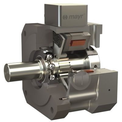

Mayr offers an intelligent solution for the monitoring of safety brakes with its ROBA-brake-checker module. The module works without sensors. It detects the movement of the armature disk by analyzing current and voltage, and knows what condition the brake is in. In addition to the switching condition, temperature and wear, the ROBA-brake-checker also monitors the pull-in distance or tensile force reserve, i.e. whether the magnet is still able to attract the armature disk. With the new module, substantially more parameters are depicted than with microswitches and sensors. On reaching the tensile force reserve, the ROBA-brake-checker emits a warning signal early enough so that a certain operating time for the brake is still possible.
In addition to the signal itself, the module also supplies for example through an optical interface, data on the switching time, the current, the voltage, the resistance, the power and the relative attraction current. The latter permits conclusions to be drawn regarding critical brake operating conditions. Using an evaluation program, the customer can see whether everything is running smoothly or whether there is work that needs to be done. For example, an air gap which has become too large is detected in good time. Safety becomes visible, so to speak. Maintenance becomes plannable – the system operator or manufacturer is able to undertake maintenance in a targeted manner, aligned to their working processes. Furthermore, in case of problems, the error output also makes remote maintenance possible.
The ROBA-brake-checker module is now also available in an alternating voltage design. In a further development stage, the module simultaneously also takes over the control of the brake, thus replacing the rectifier. The switching condition monitoring and brake control are therefore combined in one device, and users do not need to procure additional components. In addition, small brake sizes from a braking torque of 0.7 Nm can now also be supplied and monitored using the ROBA-brake-checker.
