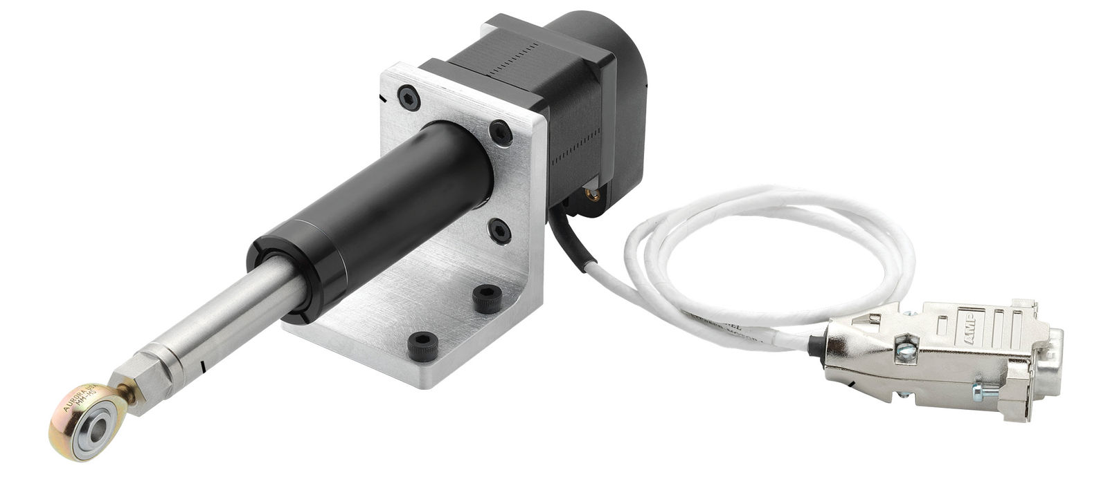

    Usually, the need for customization often emerges after the project begins.  For example, a company that specializes in customizing semi-trailers required several modifications to adapt actuators for use in ramps, stairs and movable floor assemblies. Fitting ramp lift actuators inside the trailer wall required rotating the motor 90 degrees. The ability to mount actuators within custom ramp frames while still connecting to the standard mounting points required extending the actuator tube by four inches. Simplifying future maintenance involved retrofitting the wiring connections with an easily detachable harness.
    MLA Custom with caption: Collaborating with a manufacturer that has vast experience in customizing linear motion components produces both immediate benefits for the design project as well as long-term benefits for the application. (All images: Thomson Linear Motion Systems)
    Collaborating with a manufacturer that has vast experience in customizing linear motion components produces both immediate benefits for the design project as well as long-term benefits for the application. (All images: Thomson Industries)

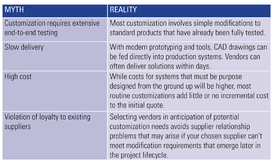

    Thomson Linear has created a handy chart to examine the myths versus the realities of linear motion product customization:

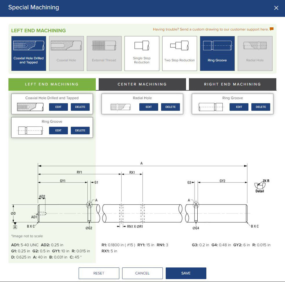

    Online resources such as the round rail selector tool from Thomson Industries allow designers to make real-time changes, choose a material, add special machining (pictured), receive a quote and lead time immediately, and purchase their solution, thereby saving them costly time and keeping projects on track.

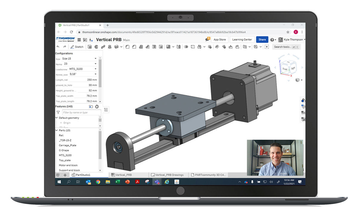

    A Thomson virtual design consultation is a live, online engineering session where you create, customize, and optimize a compact linear motion system from scratch alongside a Thomson Linear expert.

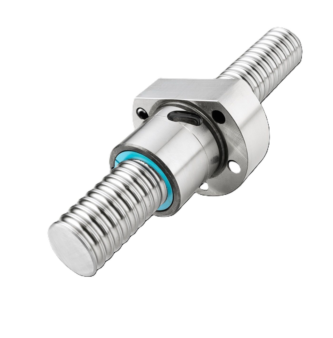

    Even if the business relationship begins with a customization need, it can sometimes be met inexpensively by mixing and matching standard components. For example, a supplier of CNC tubing and pipe bending systems sought help in designing a new machine to meet market demand for a scaled-down system. Their high-end system used two linear slides bolted together in a cross configuration to control motion on an XZ axis, using stepper motors to drive a 2-foot ball screw on each axis. The long length of the screw required support bearings on both ends and a special coupling to the stepper.
    The first thing the linear motion component manufacturer did to reduce the cost was shorten the shaft to an 11-inch lead screw with a 6-inch drive, which eliminated the need for support at both ends. Specifying a stepper motor with an integrated motorized lead screw (MLS), reduced the need for external support further because the MLS motor bearings could support the load themselves. And because the lead screw and MLS rotor are combined into one part, there was no longer a need for external coupling of the screw and the rotor.
