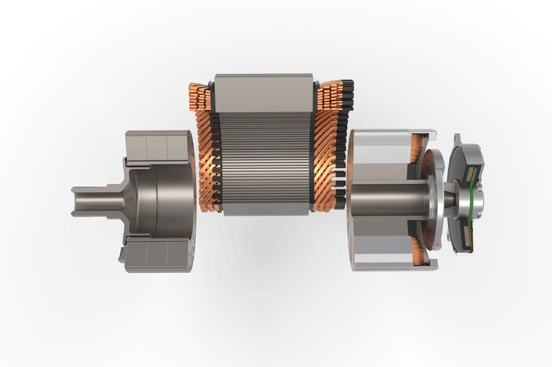

A new technology kit for electric motors on display at CES combines the advantages of Mahle's benchmark SCT (Superior Continuous Torque) and MCT (Magnet-free Contactless Transmitter) electric motors. The "perfect motor" combines permanently high peak power, contactless and thus wear-free power transmission, the absence of rare earths, and maximum efficiency.
With its bionic battery-cooling plate, Mahle has achieved a technological leap forward by using nature as a model. The company's all-new positioning system for wireless charging was recently chosen as the global standard technology by SAE International.
Mahle's technology kit for electric motors featured at CES 2024 combines the advantages of the company's benchmark SCT and MCT electric motors. With this unique technology toolbox for electric motors, Mahle can offer its customers customized electrification solutions for any vehicle class, application, or even brand philosophy.
The MCT and endurance champion SCT electric motors are among the latest innovations from the German automotive supplier in the field of electric drives. Dispensing with rare earths in MCT technology not only makes production more environmentally friendly, but also brings advantages in terms of costs and raw- material security. It is particularly efficient at almost all operating points.
The MCT electric motor shows its efficiency advantages to the full, especially in those areas that are frequently used in real road traffic. The MCT electric motor is characterized by high durability because the necessary transmission of electric currents between the rotating and stationary parts inside the motor is contactless and thus wear-free. The motor therefore is maintenance-free and suitable for a wide range of applications.
With the SCT electric motor, Mahle currently has the most enduring electric motor in its range. The traction motor can operate at high power for an unlimited period of time. This technological leap was made possible by a new cooling concept. Innovative integrated oil cooling not only makes the e-motor robust, but at the same time also allows the waste heat generated to be used in the vehicle's overall system. The new e-motor is unrivaled in its small size, light weight and efficiency. The extremely compact design also results in a material-cost and weight advantage; a lighter motor requires less material in production and at the same time increases the possible payload in commercial vehicles.
