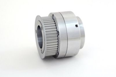

After investigating the motor, gearbox and belting, engineers determined that a torque limiter, placed on the gearbox output shaft, would prevent the belt from breaking when set to a slip torque of approximately 100 lb-in. A big challenge, however, was the small amount of space available for this component. The output shaft of the gearbox had a diameter and length of 30 and 80 millimeters, respectively. In addition, the torque limiter had to be able to withstand washdown.
Achieving the Required Torque in a Limited Installation Space
To meet these requirements, Mach III designed a torque limiter that utilizes a stack of Belleville springs to provide the required torque capacity. They mounted the pulley that drives the belt directly on the torque limiter. Due to this design, the company didn’t have to alter the machine frame or reposition any existing components. Rather, the torque limiter fit within the existing space on the gearbox shaft. Outfitted with aluminum, enclosed housing, the torque limiter also successfully met the application’s washdown requirements.
