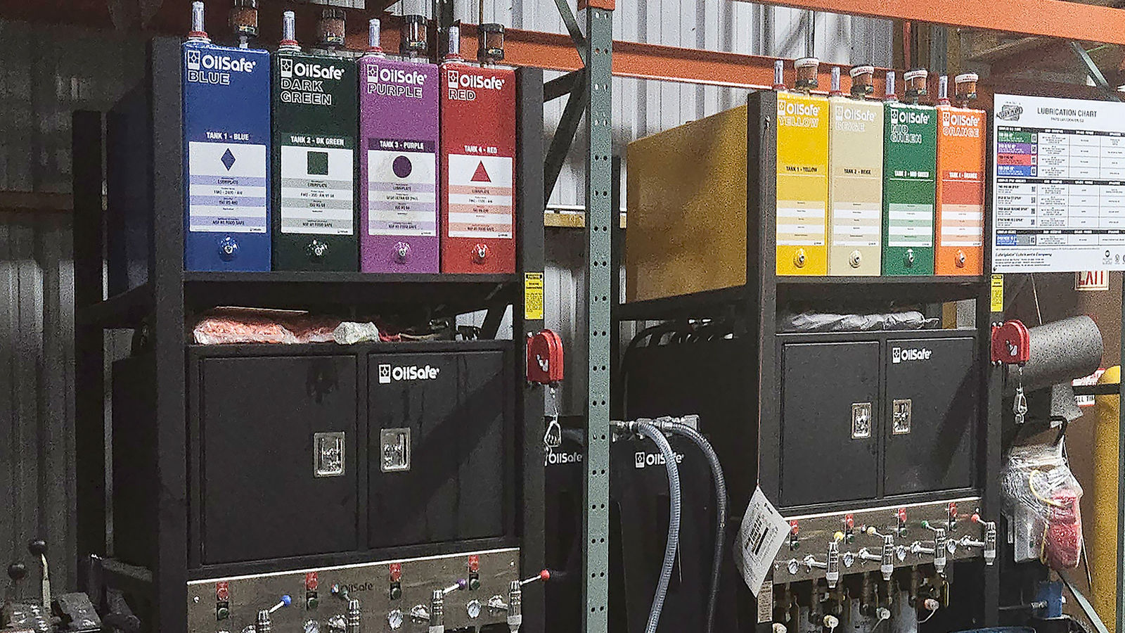

  • Creating a Lubrication Legend: Develop a clear visual legend using color codes and symbols to match lubricants with specific equipment (Figure 1). Your lubricant and equipment provider can be invaluable in this process. Include clear warnings against mixing fluids—debunking the myth that all greases and oils are compatible with mixing. Verifying compatibility upfront prevents costly problems down the line.

  • Dedicated Lubrication Room: Designate a well-lit, restricted-access lubrication room for storing bulk containers, pails, greases and aerosols. This room should have lockable (and potentially fireproof) cabinets, climate control to prevent moisture buildup and appropriate equipment for storage, dispensing and transportation.
  • Spill Prevention and Control: Install spill containment decks or pallets beneath all dispensing equipment. Ensure spill kits are readily available in the storage area for immediate cleanup.
  • Designated Transport and Equipment Areas: Define specific areas for storing lubrication equipment and filter carts, adhering to company policies for safe lubricant transportation within the plant.
  • Clear Identification System: Implement a consistent identification system that mirrors the usage legend established for equipment and ensure a legend copy is posted in this room. Use color-coded labels and shapes to identify lubricants in storage and at dispensing points throughout the plant. This visual system enables lubrication technicians to quickly and accurately locate the correct lubricant for each application.
