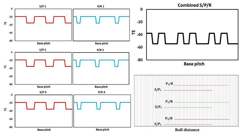

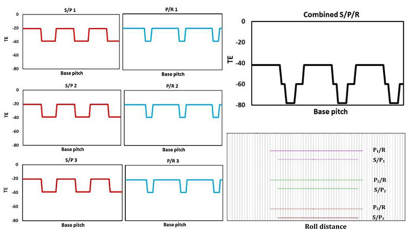

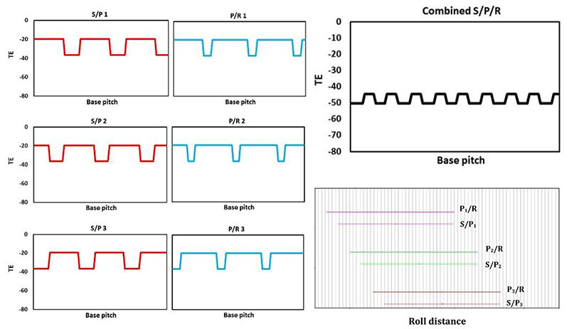

Regardless of whether a design is sequential or not, there also exists the phasing between the sun/planet (S/P) to the planet/ring (P/R), which can themselves be either in or out of phase.
The notion of phasing is investigated using commercially available gear analysis software (Dontyne) (Ref. 11) which adopts simple strip theory (Ref. 12) to establish the quasi-static TE. Here, tooth stiffness is assumed parabolic and a maximum at the pitch point, falling to approximately 70% at the start and end of active profile (Ref. 13). Combined with load sharing, micro geometry corrections and misalignments, the total expected quasi-static TE can thus be established. Using an iterative approach, the analysis also accounts for unequal load sharing amongst the planets due to differences in the instantaneous mesh stiffness between out-of-phase planets. An arbitrary example illustrating the effects of phasing is presented in Figures 1 through 3, for factorizing and non-factorizing designs, with ‘n’ planets, and sun, planet and ring tooth numbers of zs, zp and zr respectively. For simplicity, each planet experiences equal load with a constant mesh stiffness, the details of which are presented in Table 1. Here, without presenting the specific details of load or geometry, the magnitude of the TE is irrelevant, and the example is merely presented to provide the reader with a greater understanding of planetary phasing, and the potential reduction in TE with only slight modifications to tooth numbers.
Table 1: Tooth numbers for factorizinf and non-factorizing designs
Example 1 is factorizing, such that the phasing of all S/P are identical. Likewise, the phasing of all P/R are identical, as illustrated in Figure 1. Note however, regardless of the factorization, the length of the path of contact of the S/P is less than that of the P/R, as illustrated in the phasing diagram Figure 1, whereby the P/R engage and exit mesh before and after the S/P respectively. In this example, the total combined TE is a direct combination of the S/P and P/R. Example 2 is still factorizing, however there is a distinct shift in the phasing of the S/P with that of the P/R as illustrated in Figure 2. As a consequence, when the TE of the S/P is combined with that of the P/R, the total TE (17 μm) is significantly less than that presented in example 1 (37 μm). Finally, example 3 adopts a non-factorizing design such that the phasing of all the S/P are different, as are the P/R. As a consequence, the total TE has been reduced to only 6 μm, as illustrated in Figure 3.

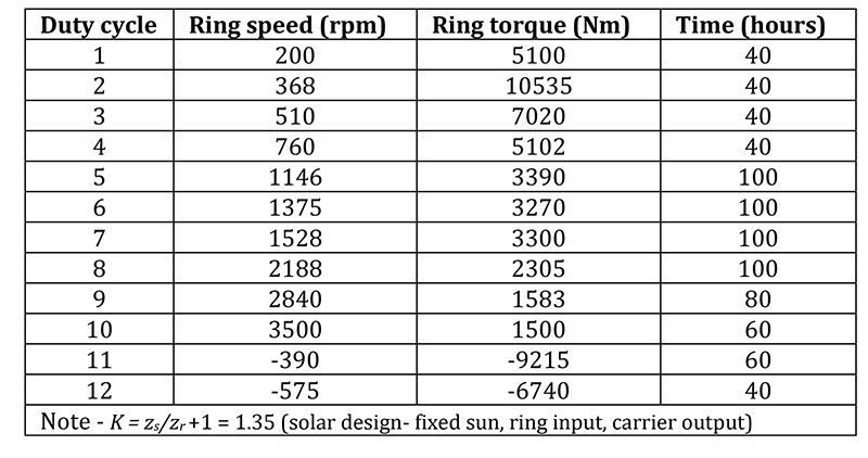

The objective of this research was to utilize the theory of phasing to optimize an existing epicyclic gearbox to produce the lowest TE, whilst understanding the resulting implications with regards to the complexity, cost, weight and possible risks. To facilitate this, an initial design and detailed specification was required, whereby a load spectrum, together with a required ratio and epicyclic arrangement fully defined the system, as detailed in Table 2. Each design was analyzed in the first instance for strength, in accordance with ISO 6336:2006, then optimized by analyzing the elastic mesh deflections such that the transmission error was further minimized using micro geometry corrections. In addition to the optimization process, each gearbox was fully designed and detailed, including housings, carriers, shafts, bearings, splines and the lubrication delivery system, only after which can the true benefits and implications of each design be fully understood.
Table 2: Duty cycle
Gearbox A. The base design was an existing spur gear system with 5 planets, and sun, planet and ring tooth numbers of zs = 35 zp = 32 and zr = 100 respectively, such that the planets were equally spaced and factorizing.

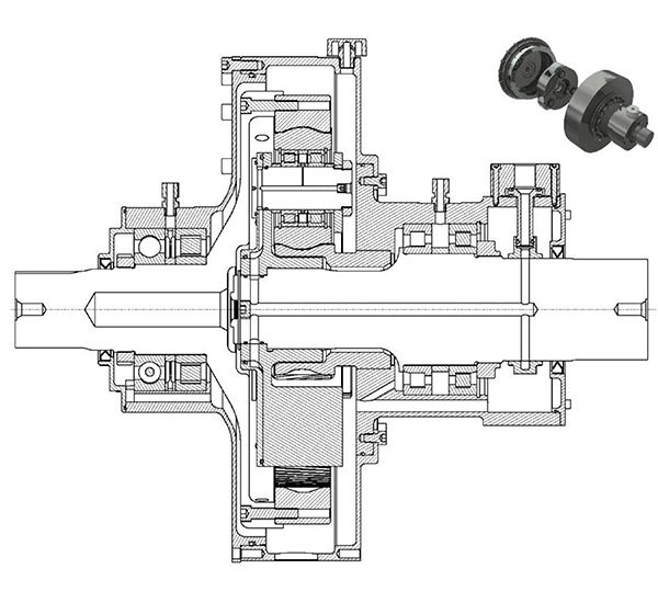

Gearbox B. With only slight modifications to the tooth numbers specified in Gearbox A, and a small change in the gear ratio, the macro geometry was modified such that it was now non-factorizing by adopting sun, planet and ring tooth numbers of zs = 36 zp = 34 and zr = 104 respectively, while maintaining equal planet spacing and the use of 5 planets. The basic rack profile and pressure angles were modified such that a transverse contact ratio greater than 2 was achieved, resulting in an HCR design.

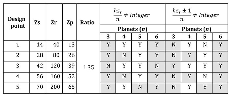

Table 3: Elimination of torsional and transverses modes

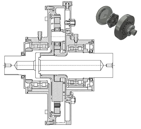

Gearbox C. Gearbox C adopted helical gears, with an integer overlap ratio slightly larger than 1. Table 3 presents a list of viable tooth numbers, without addendum modification, which satisfied the required gear ratio, equal planet spacing, and the potential to eliminate torsional and transverse modes of excitation, based on equations 1 and 2 respectively, analogous to that previously presented by Palmer and Fuehrer (Ref. 2), for the first harmonic (h). Equal planet spacing is represented by the shaded cells in Table 3.

Taking into consideration cost, weight, planet load sharing factors, shaft sizing and bearing loads, design point 4, with 3 planets, was considered a good compromise based on gear diameter and module and gave a balanced design with regards to contact and bending safety factors. Furthermore, it provided a sequential design with equal planet spacing, albeit at the expense of potential transverse vibrations. The final macro gear geometry chosen for all three gearboxes, A, B and C, is presented in Table 4. Detailed gear stress analysis for both new designs (B and C) was conducted in accordance with ISO 6336:2006, using the load spectrum presented in Table 2, ensuring each proposed design provided minimum contact and bending fatigue safety factors of 1.0 and 1.4 respectively. Each design adopts a suitable planet load sharing factor determined in accordance with AGMA 6123-B06, depending on planet numbers and system flexibility. The remaining mechanical design of both Gearbox B and C was conducted in accordance with 1) AGMA 6001-E08 for shaft stressing, 2) ISO 281 2007 for advanced bearing life, 3) DIN 5480:2006 for spline geometry, and 4) SAE M-117 for spline stress analysis, the results of which are illustrated in Figure 4 and 5.

Figure 4 Gearbox B, HCR spur design.
Figure 5 Gearbox C, IOR helical design

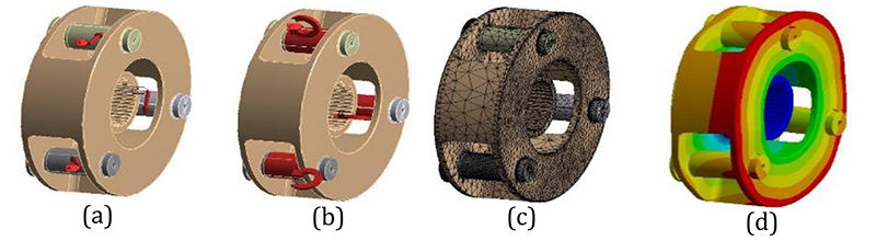

Loaded helix slope deviation (fsh). The loaded shaft deflections, including both bending and torsion, were established for the sun, planet carrier and ring, using ANSYS finite element analysis (FEA) whereby the actual component architecture was analyzed under operational loads and boundary conditions. The ring and sun gear were analyzed by incorporating the base tangent and axial forces where applicable, located at the point of planetary contact, thus establishing the resulting deflection in the direction of the line of action, across the face width of the gear. The planet carrier pins were subjected to twice the tangential force (2Ft) and an overturning moment (Fa/dp) to compensate for the axial gear forces, where applicable. An example analysis of gearbox C is illustrated in Figures 6 through 8.
Loaded Profile Slope deviation (δ). In the transverse plane, each tooth deflects by an amount (δ) which is proportional to the mean mesh stiffness (Cγ), facewidth (b) and transverse load (Ft). This deflection value is used as a first approximation for the amount of tip relief required in the optimization process.

Figure 6: Ring FEA with (a) base tangent forces (b) axial forces, (c) mesh discretization and (d) deflections.
Figure 7: Sun FEA with (a) base tangent forces (b) axial forces, (c) mesh discretisation and (d) deflections

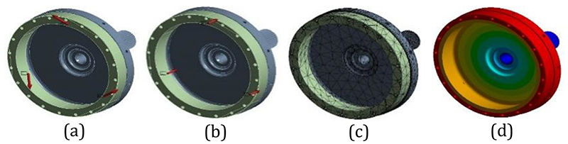

Figure 8: Planet carrier FEA with (a) tangential forces (b) overturning moment, (c) mesh discretization and (d) deflections.

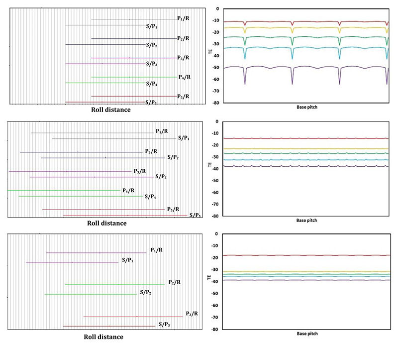

With the optimized macro and micro geometry, the TE was established for all three gearboxes, the results for which are presented in Figure 9, at various torques up to 10k Nm at 2k Nm intervals.

Figure 9: Phasing and transmission error for gearbox A (top), B (middle) and C (bottom).
Gearbox A was a simple factorizing spur design, with 5 planets. This base design, without any micro geometry modifications, exhibited significant TE as illustrated in Figure 9. With only slight amendments to the tooth numbers, pressure angles and tooth height, a non- factorizing HCR gearbox was designed which significantly reduced the TE. With the introduction of the IOR Gearbox, also non-factorizing, this was reduced even further to sub-micron levels across the entire load spectrum. Hence, the use of phasing, combined with increasing the transverse or axial contact ratio has been shown to dramatically reduce TE. However, every design concept had significant ramifications, as follows.
  1. Choosing a factorizing design such that the torsional mode of excitation is neutralized at meshing frequency, does not eliminate torsional excitation at certain higher harmonics or other transverse and rotational excitations.
  2. The HCR design is vastly simplified, mainly due to the lack of axial gear forces. Conversely, the IOR design required a much larger gear face width to a) accommodate suitable planet bearings, and b) reduce the magnitude of the helix angle required to maintain an IOR, and therefore reduce the axial forces, and planetary moments.
  3. The HCR gearbox adopted a simple side spray lubrication system via jets situated at various static positions around the housing. This minimizes churning loses, improves efficiency, and was deemed suitable to lubricate the gears and single planet bearings. However, concern lay with the IOR gearbox, and the need to ensure adequate lubrication to both planet roller bearings — specifically that closest to the carrier — which may not receive satisfactory splash lubrication. Thus the IOR gearbox adopted a more complex delivery system, via the carrier shaft, simultaneously providing oil to the planet bearings, via the pin, and the planet gears, via the carrier walls. Here, the oil jets are static in relation to the planet positions, such that they can supply a constant jet of oil directly into and out of mesh, with a jet velocity equal to or greater than the pitch line velocity. However, this required a non-contact rotating union delivery system, accurately constrained via a complex two-bar linkage system. See Figure 5 for further details.
  4. Sequentially phased designs produce a small residual radial load. However, that said, even an in-phase design, with balanced radial loads and therefore a theoretical requirement for no radial support, may still exhibit a potentially much greater residual radial load due to unequal planet load sharing. As a consequence of this load, and any potential external radial loads generated due to the eccentricity of any connecting shafts into and out of the gearbox, both the input (ring) and output (carrier shafts), in these examples, were fully supported.
  5. IOR axial forces must be reacted by, and accounted for, in the life of suitable ring shaft bearing. Note that since the sun gear was static, the axial loads were easily reacted, whilst those on the planet carrier cancelled.
  6. The added complexity of adopting helical gears, with the need for twice as many planet bearings, large facewidth gears and a complex lubrication system, produced a design which was considerably heavier than the HCR design. It may therefore be assumed that HCR design is a sensible compromise, however, it should also be noted that the sensitivity of the HCR TE due to pitch and profile deviations were such that a greater gear accuracy would be required to maintain the benefits of such a system.
  7. The benefits of phasing is more complex than simply ensuring a design factorizes or not. The phasing diagrams presented throughout, highlight the need to consider the relative positions and length of engagement of the sun/planets, planet/ring and ring to sun.
