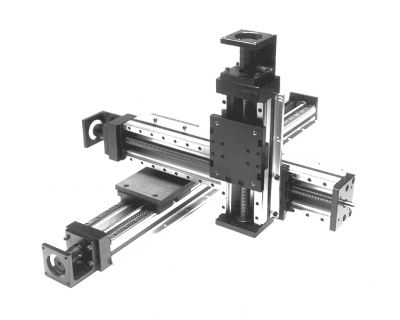

The Lintech 100 series linear positioning slides are designed to maximize performance while minimizing physical size and cost. These linear slides use a low friction, preloaded, recirculating linear ball bearing system, which ride on precision ground linear square rail guide. The linear profile rails are mounted to a precision machined aluminum base, which offers a rigid support over the entire travel of the table's carriage. The load is mounted to a precision machined aluminum carriage, which has threaded stainless steel inserts for high strength and wear life.
There are 30 different acme and ball screw options, that offer high efficiencies and long life at an economical price. These linear positioning tables are designed to allow for numerous options. They include EOT & Home switches, linear and rotary encoders, power-off electric brakes, motor wrap packages and versatile mounting brackets for multiple axis applications.
Lintech has the ability to build any of its standard positioning systems in single or multi-axis, using pre-engineered mounting brackets. Mix and match different axes for a customized linear robotics solution.
