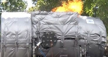

Lefae is the Emitech Group's laboratory specializing in environmental testing with severe constraints: fire testing and combined climatic testing. Based in France near Lyon, it has just qualified a new testing facility for verifying the conformity of equipment installed in potentially explosive zones (equivalent to ATEX requirements) in the presence of hydrocarbon fluids and vapors. Conditions of explosivity are often found in the aeronautics and military industry, but also in the automotive and marine industries.
Lefae's new bench is designed for carrying out tests in an explosive atmosphere. These tests specify the requirements and procedures for aircraft equipment which could come into contact with flammable fluids and vapors. This equipment is generally associated with fueling systems, such as tanks, pump units, valves, monitoring and control instruments, etc. This type of test encompasses both normal and fault conditions potentially occurring in zones that are or may be in contact with flammable fluids and vapors during flight operations.
The conditions for explosivity are obtained by producing a stoichiometric air/fuel mixture in sufficient proportions to exceed the Lower Explosivity Limit (L.E.L.) of this mixture. The nature of the components of this mixture must be taken into account as well as the conditions of temperature and pressure under which the mixture is created. Flammable test fluids, vapors or gases simulate those normally used in conventional aircraft and which require oxygen for combustion.
Testing in a real environment
The tests performed by Lefae comply with the requirements of EUROCAT-ED-14D, RTCA DO-160, MILSTD-810 standards. They enable functional tests to be run on the equipment in an explosive atmosphere without triggering the explosion of the stoichiometric air/fuel mixture. They evaluate the capacity of the protective enclosure (ATEX requirement approach) of the equipment under test to contain an explosion or a flame when the equipment is activated. The characterization of the containment is then carried out by introducing the explosive mixture and then triggering it. The test also reveals overheating of the circuits or components in hydraulic or exhaust systems for example, and intermittent or permanent hotspots capable of triggering the explosion of the mixture.
Lefae carries out tests in a real environment and all climatic, mechanical, hydraulic, or electrical conditions. The test bench has been designed to the following specifications: the chamber volume is 450 dm3, absolute pressure conditions up to 12,200 meters (40,000 feet) in altitude, temperatures up to 120°C (248°F). Sealed passages are available in the walls of the test chamber to accommodate controls or supply to the equipment under test, for example electrical controls, fluid supply or mechanical activation.
The bench can also be used to investigate the behavior of intrinsically explosive products and analyze the toxic gases resulting from their explosion. For example, Lefae conducts studies on the thermal runaway of Lithium Ion cells and batteries. Explosions and fires triggered by thermal runaway are analyzed to determine the explosion pressure, the fire ignition and to analyze the gases toxicity level produced during cell or battery failure.
